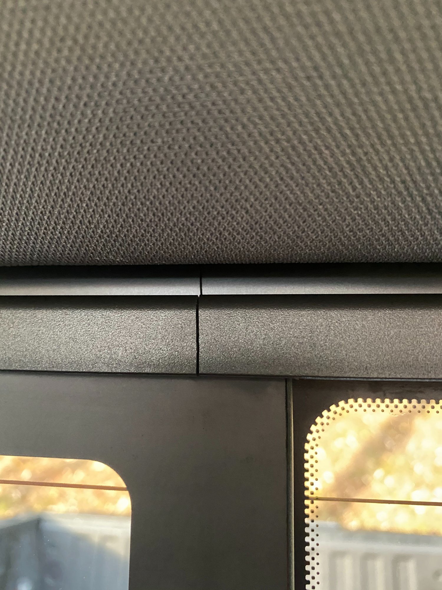

First time poster, long time lurker. I have a 10/2018 built T1 with the rear window leak issue. I have already opened a case with GM corporate and am scheduled to drop off the truck at the dealership tomorrow morning. In my case, the top of the window frame is cracked all the way through and is visible within the cab. I am concerned that the dealership is going to attempt to reseal the window and not replace the window. Any advice before I drop off the truck tomorrow? Based on this thread, I am anticipating that this will be a lengthy process before I have a resolution.
I would just make sure to point out that full thickness crack and make very clear it needs to be a new window. I believe that is what the TSB mentions as well, that they need to inspect the frame and if cracked, replace.  Good luck, going to be a long ordeal unfortunately.
