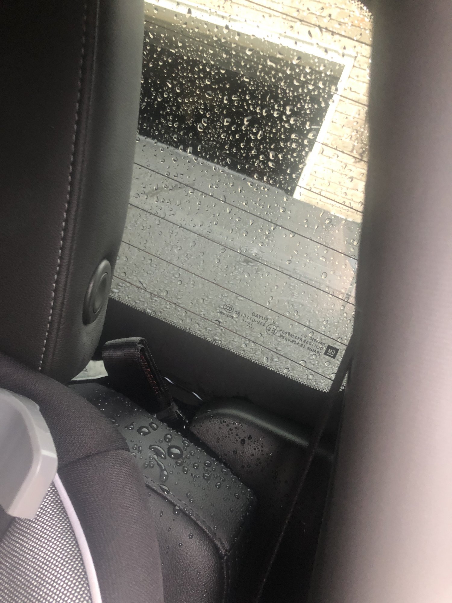

I've been hit. Build date February of 2019. Taking to dealer now for this and loose column shifter. 50650203a42ab4030588909f2af75dae.jpg
Sent from my SM-G965U using Tapatalk
