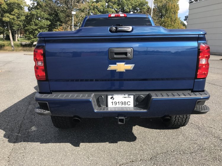

On ‎11‎/‎17‎/‎2018 at 1:17 PM, XtcVisions said:
Just removed mine or my 14 silverado, couldn't tell
