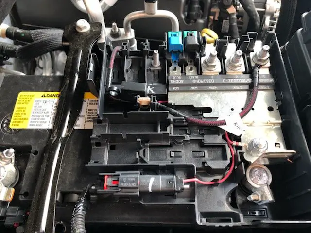

You should check your battery connection at least in 2 places...
1.  Did you re-seat the negative battery correctly and tighten it
2.  Did you wire the Pos line to the right fuse set?  See My Pic.
Third thing is did you splice into the correct wires on the passenger side or damage one while removing the insulation?

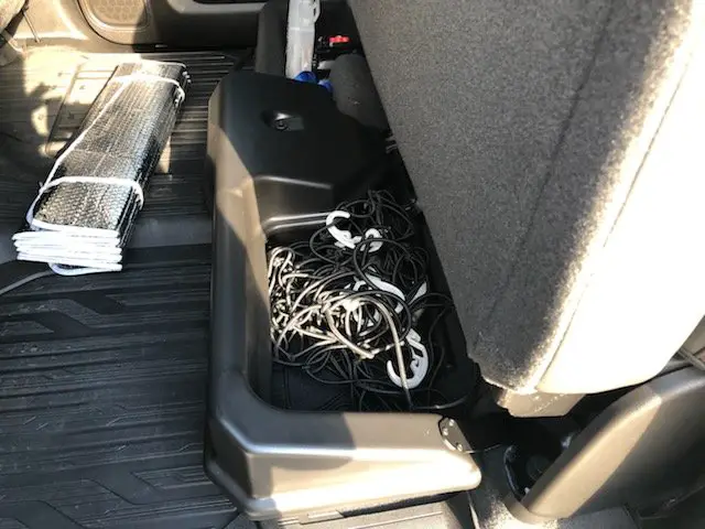

7 hours ago, GMC-AT said:
pic
Looks nice.  I modified my storage to fill in the rest of the space.
Edited by quicksilverc5
Looks great, I like the storage mod -
