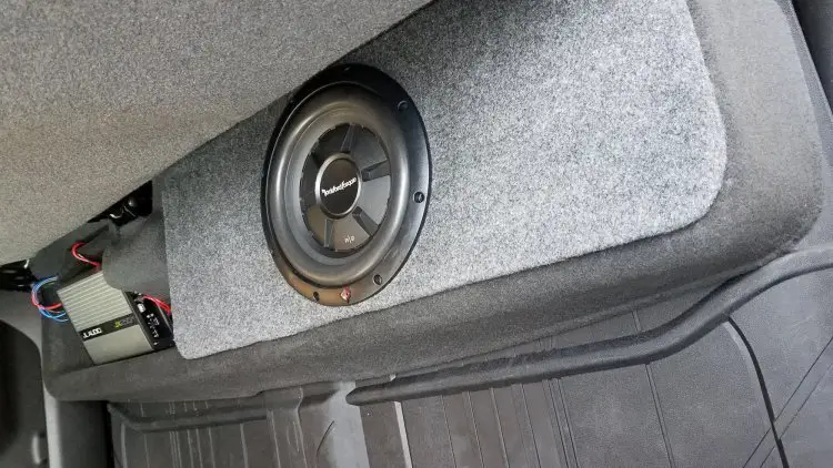

I had my own made...fits right inside the factory box under seat.  Just factory BOSE with a little extra 12in kick in the back.
  • Like 4
  • Thanks 1
^^^This is the exact design for what I was planning on doing - The space is perfect for eights in my opinion. I havent measured yet but I will throw three dual voice coil JL audio 8s wired in parallel in the space with an amp (if it fits)..It will kick like a mule.
I had this design in a previous truck and I had to turn it WAY down because it would drive you out of the truck...
Edited by Chris walker
some more pics. The box is actually fiberglass molded around that factory box. I need to clean up the amp a little.. but you get the idea.
Also - adding a base knob up front is important.
This set up is probably the same less $$ as the factory kicker sub.. but I can guarantee it rocks more.
