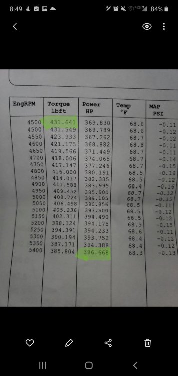

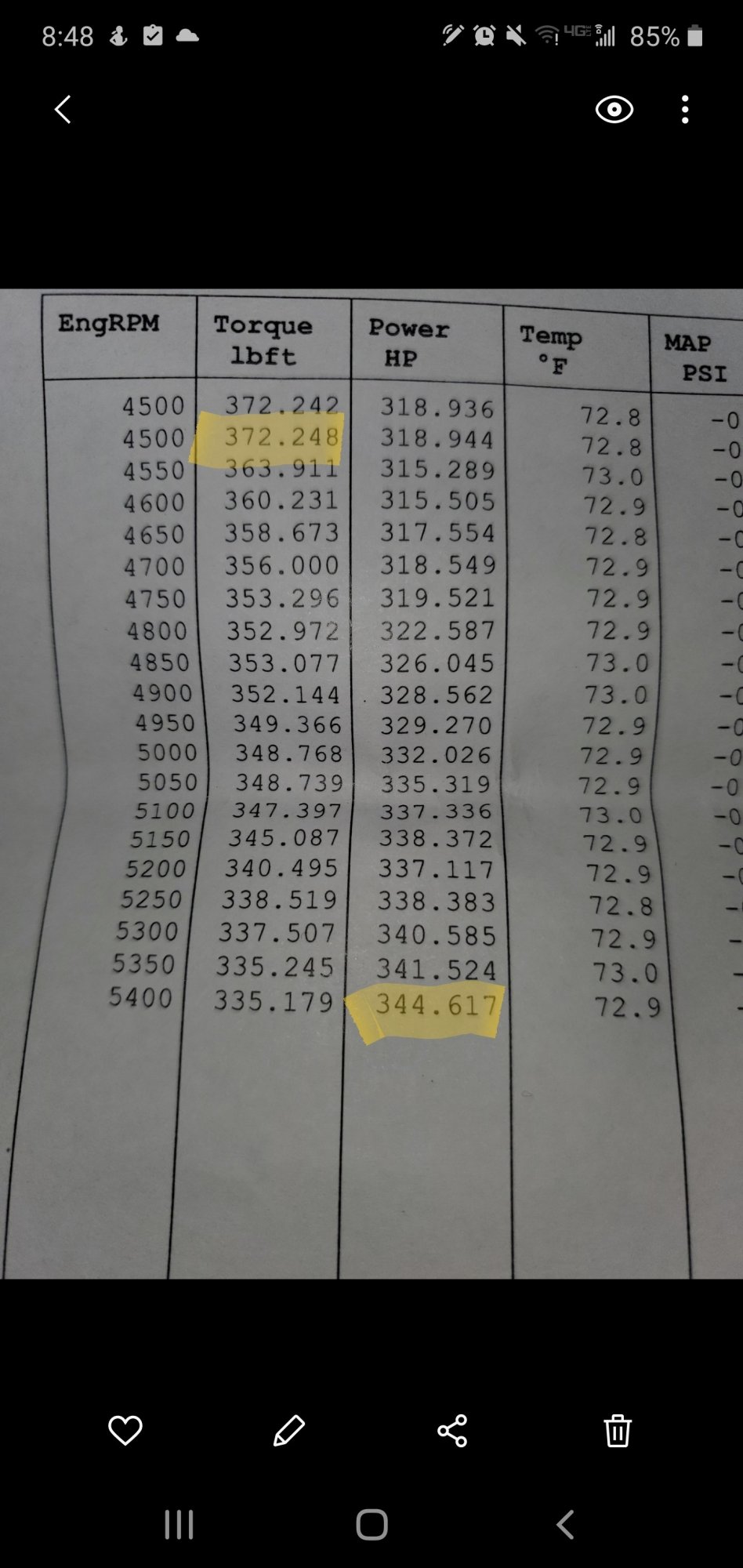

I have a 2019 Denali with a 6.2l, had a custom made exhaust from Heartthrob Exhaust designed and built (now available as a kit from their website, you're welcome). Dyno sheets showed a 52rwhp gain. Noticeably different while driving and not obnoxiously loud at all. Yellow is before, green after.
See video of sound here.
 I am puzzled why this hasn't been broadcast everywhere.  50 HP for a cat back, meaning emissions and warranty aren't affected.  They only show one for a short bed but I'll bet they'd make one for a standard bed.....

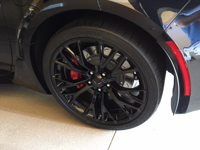

Well, they definitely feel stronger than my 2015 Denali, but I actually only have about 650miles on it so far with working from home.
Yes they are the Brembo brakes, and actually look the same as the ones on my Z06. The only odd part is that the brake life monitor is maintained on the rear brakes, but not on the front.
