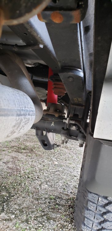

Included a couple of half ass pics but you can see it’s on the bump stop and this is with an aluminum trailer without my car loaded.
Looks like that could be the new carbon composite leaf spring on the bottom of the spring pack?
In that picture it looks to me like there is either too much tongue weight or something is not right with your springs. I assume the trailer is empty in this picture like you said earlier. Did you check the sticker in the door jamb to see what the GVW is? I believe you can have a tongue weight of 10% of the GVW. So if the GVW is 9300 pounds the tongue weight can be 930 pounds. The trailer axles are supposed to carry the majority of the weight. If the tongue weight is too much or even too little the trailer starts to "drive" the truck.
