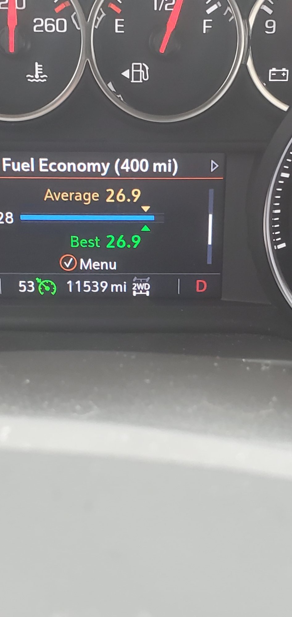

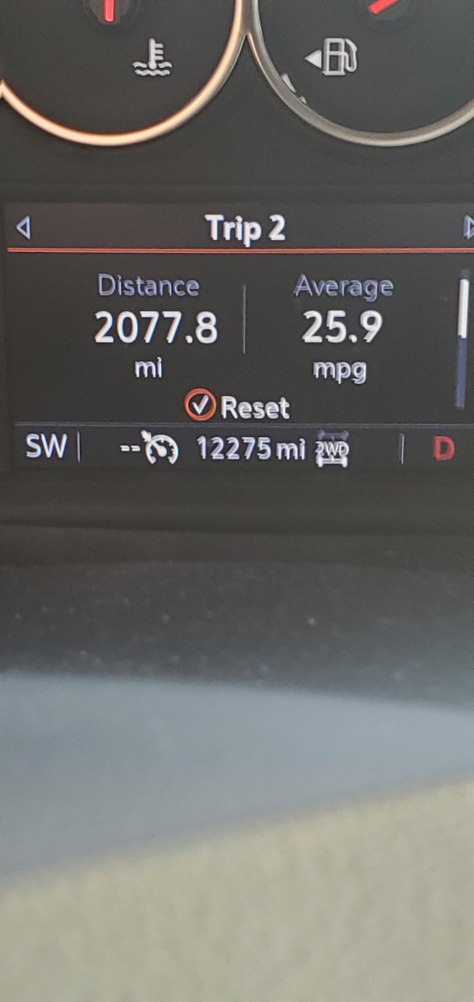

I've been watching this thread since I started shopping for a truck. Thanks to all those that have contributed such informative posts. I bought a quad cab 2.7 4x4 in August of 2021. I was sweating it with this new engine. It drives great but I was nervous. I've put some effort in to improving fuel efficiency and lately I've dropped the cruising speed a few mph to mitigate the cost of gas. I'm satisfied with the results. I am actually doing better than I expected but it would definitely be nice to be able to do this at 5-10 mph more!
53 MPH the average for both those results?  I run 65 mph here in CO with my Trail Boss and no wind can achieve 24+.
No no. Average is definitely higher than that though I can't say exactly. Somewhere closer to 58. I am not on interstates much. Rural 45, 55 and 60 mph zones. Though to keep the mpg average high I do take opportunities to make certain drives around 50 when I reasonably can. Though from the sounds of it maybe I should be doing even better. I am using good engine oil, currently motul 8300 though usually amsoil, I put redline in the rear diff, and a k&n filter all just to keep efficiency up. Last things to do are amsoil atf and maybe some semblance of an under tray to help out aero just a tad. Nothing overboard.
