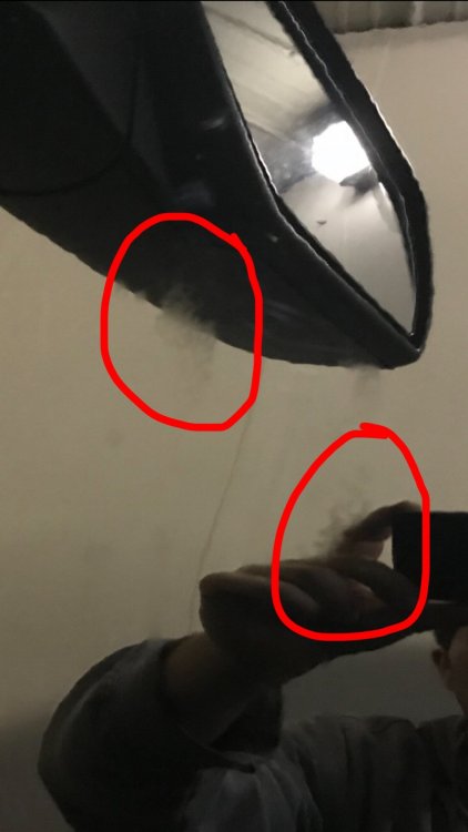

MarkusFATA Posted April 10, 2019 Posted April 10, 2019 Hi all, 2018 Silverado, black, 5000 miles. Noticed a perpetrating pooper took a dump down the side door of my new Silverado. No big deal, if I had to guess I found it within an hour of it happening. As I would with all my other vehicles I hand wash it real good and wax it. Unfortunately it seems that the crap has ate through multiple spots of my paint. I know the paint on these trucks suck, but this is unacceptable. I've never had a vehicle do this. My daily driver/beater car which is also black has 200k on the odometer and only gets a bucket wash once a year and I have never had bird crap eat through the clear coat. Any suggestions? Think the dealership would do anything or just tell me to piss off?
TJay74 Posted April 10, 2019 Posted April 10, 2019 just need to clean the hood, clay bar it and then polish the spots out. Then once done clean it again and put a good sealer on it. I dont use much wax these days, they dont last as long as a true sealers do.

jaxcam02 Posted April 10, 2019 Posted April 10, 2019 clean, clay and polish it. Then protect with a sealant or quartz coating.
Lsgun1 Posted April 10, 2019 Posted April 10, 2019 It will clean out with more than a wash. Meguiars sells a kit with Ultimate compound, polish and wax. you can do it all by hand if you don't want to buy a polisher.

tyler.frost92 Posted April 10, 2019 Posted April 10, 2019 Light polish will take care of that, hell it might come out with just clay.
MarkusFATA Posted April 10, 2019 Author Posted April 10, 2019 I tried rubbing compound as well as polishing compound and unfortunately neither worked. I did not try the clay bar however.

nluchau Posted April 10, 2019 Posted April 10, 2019 Same thing happened to my black truck and it was indeed bird crap. It ate through the clear and clay bar never did anything. Had it polished out but can still see where it was. This was on my 2016
tyler.frost92 Posted April 11, 2019 Posted April 11, 2019 17 hours ago, MarkusFATA said: I tried rubbing compound as well as polishing compound and unfortunately neither worked. I did not try the clay bar however. machine polish may be necessary then. Any good detailer in your area should be able to get that out in 5-10 mins. Or just take it to the dealer.
MarkusFATA Posted April 16, 2019 Author Posted April 16, 2019 Sorry for the late update everyone, after spending a weekend out of town with my family and digging through some forums I finally had a little luck. All in all I had 3 etched spots, one on the plastic trim below the hood and two on the drivers side door. I used Meguiars Scratch X and completely removed the etch on the plastic trim and was able to remove about 95% of the etched spots on the drivers door. Since I am a perfectionist I may try to wet sand what little remains on the drivers door, or just take it to a local reputable detailer and see what they can do with it. Under direct light the small pinhole sized spots almost look pitted so I hope it isn't all the way through the clear coat.
