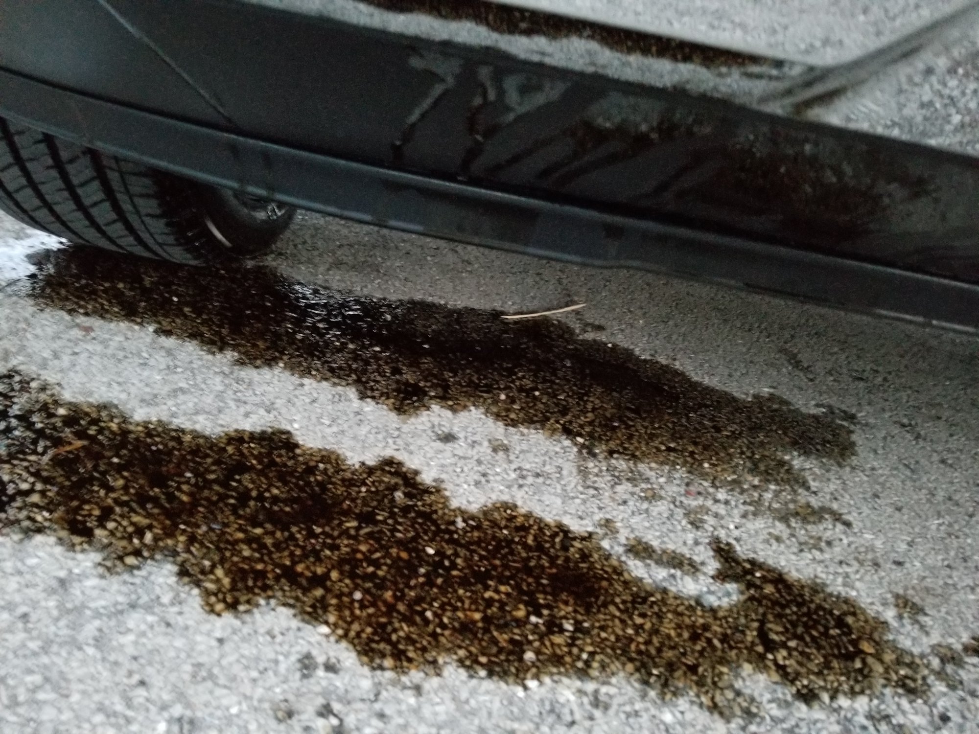

I took a short drive this evening to run errands. All smooth roads; didn't hit anything or go offroading or anything like that.

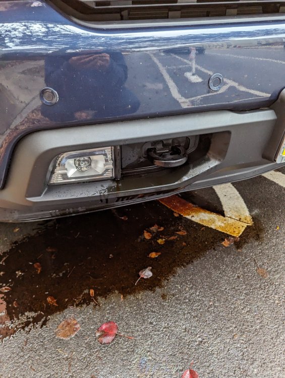

I was about 5 minutes from home and the truck starts making an audible chime sound and the DIC is flashing "low oil pressure turn engine off." I parked on a side street and turned it off. Oil was gushing out of the engine and running all over the air dam, down the knuckle to the front passenger tire and onto the street.  The whole load of oil drained out.
GMC roadside assistance towed it to my dealer. My last oil change was a couple of months ago so I can't imagine it's something like an improperly installed filter. Could the main seal fail at just 5,500 miles?? It's the 6.2L engine.
I was quick to park and shut it off, but I'm quite concerned the engine may have been harmed.

Oil cooler line it is. Had them collect an oil sample that I'm going to send away as a baseline. A few weeks after repair I'm going to change the oil again and collect another sample from the filter to send in for a comparison analysis to see if there are signs of damage.
