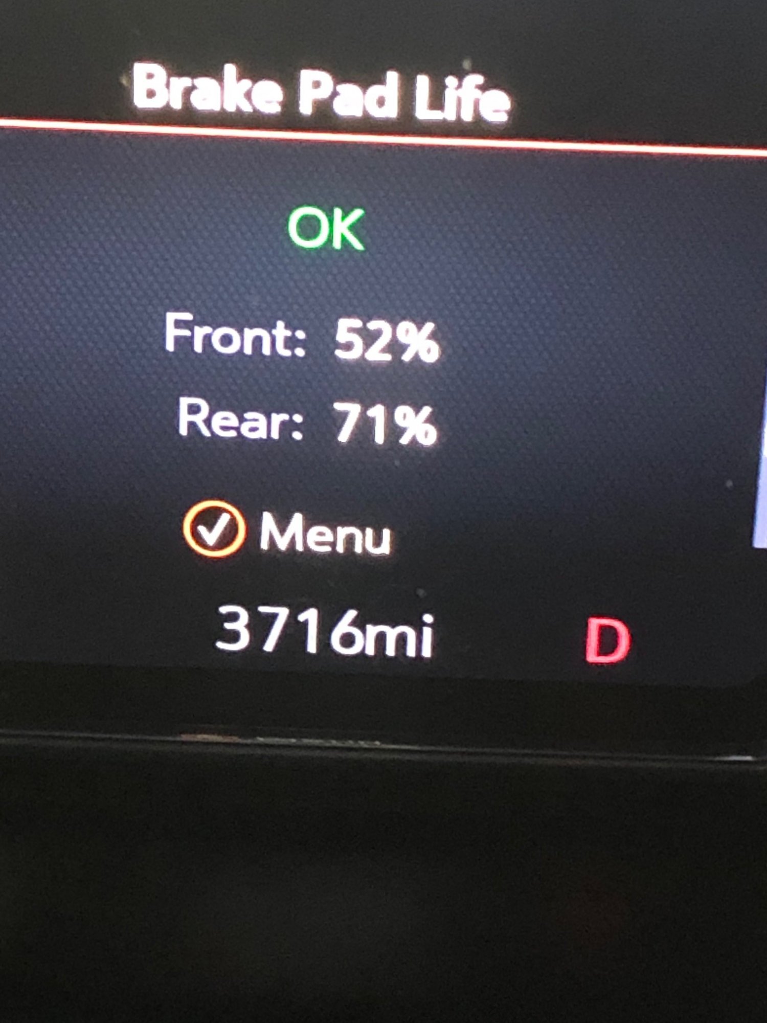

What’s Up With The Brake Wear Indicator? 3,600 Miles and 26% Gone??

My dealer did multiple updates at my oil change.  They did ECM, TCM, BCM and another brake related one to address the rapid decline with the brake wear indicator.  Also got a radio update while there too plus first oil change.  All at no cost to me!  My brake wear indicator now shows 100% front and rears.  Hopefully this issue is fixed for me.
You mind sharing what update? My dealer said they didn't know of one to address the issue when I was in there today.

I am at 37% front 49% rear... 7200 miles..highway driving... rapid decline since "service brake boost" update..and brakes are inconsistent as to pedal pressure. Taking her back in tomorrow..

As of today there is no software update for the brake wear showing on the display.  The dealers can only reset it (back to 100%).  The software monitors your driving habits and estimates the wear on the pads (useless in my opinion).  We still have the old fashion squeal wear indicators on the brakes that work.  I am not happy that they have not issued a patch if nothing else to let the owner reset the brake wear similar to resetting the air cleaner percentage.  I like everything to work properly.

There is a software update PIT5695A
This, I had it done as well, only issue is that my dealer forgot to reset the meter.
Got my truck back after the first oil change and showed them the break life % . at 5k the front pad life is at 17%. They said they hadn't seen that, now I don't believe them.
When they said it was ready I went back to pick it up around 6:30 after work. The service dept was closed and I picked it up and just drove off. They went into the display and just turned it off, not fix it. I'll be calling tomorrow.

So has anyone actually read bulletin PIT5695A to say what they are supposed to do? Usually if it has a PIT or PIP number it is still preliminary and not fixed yet. Perhaps it just tells them to turn it off and there was no software update yet
