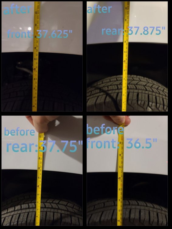

This is my 2019 AT4 leveled with Bilstein 6112’s and 2” MotoFab top spacers. It initially was 3/4” high in the front but after 100 miles settled to perfectly level.
