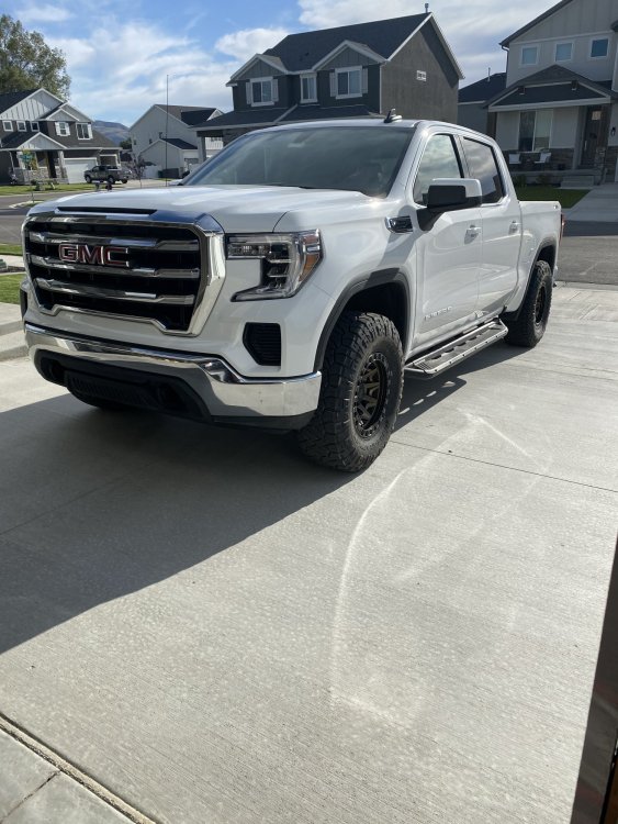

hihosilverado Posted May 15, 2020 Share Posted May 15, 2020 3 hours ago, ausomecasey said: It looks like it has plenty of room. Awesome! Thanks for passing along the picture. What’s the noise level like on the tires?? Quote Link to comment Share on other sites More sharing options...
ausomecasey Posted May 15, 2020 Share Posted May 15, 2020 43 minutes ago, hihosilverado said: Awesome! Thanks for passing along the picture. What’s the noise level like on the tires?? The noise sort of surprised me. It’s not that they are loud, it’s just more noise than the original tire. I should have expected that going to a more aggressive tire. But my wife did not even notice a difference...I’m just a little OCD. But I still really like them. They are smooth and comfy riding like the original tire which was my main priority right now. Quote Link to comment Share on other sites More sharing options...

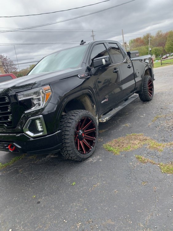

62AT422 Posted May 16, 2020 Share Posted May 16, 2020 2" level 2 Quote Link to comment Share on other sites More sharing options...

Tyler1199 Posted July 26, 2020 Share Posted July 26, 2020 On 5/15/2020 at 8:57 PM, 62AT422 said: 2" level Are you running the RC? What’s your wheel setup? Quote Link to comment Share on other sites More sharing options...
62AT422 Posted July 26, 2020 Share Posted July 26, 2020 25 minutes ago, Tyler1199 said: Are you running the RC? What’s your wheel setup? Just a 2" leveling kit. Wheels are 22x10 -18 offset w/33x12.5s Quote Link to comment Share on other sites More sharing options...

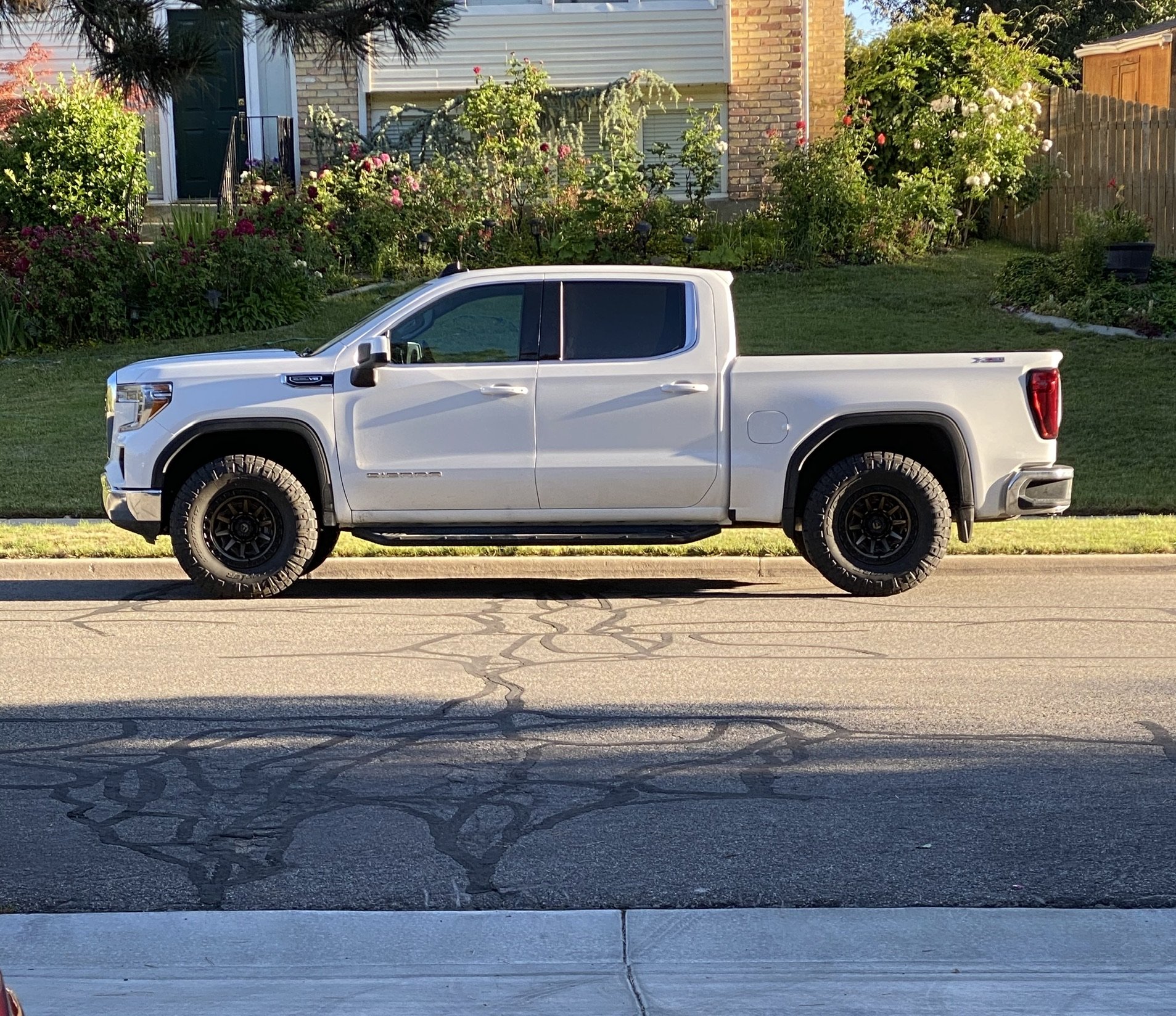

Dirty mike and the boys Posted July 28, 2020 Share Posted July 28, 2020 Here is my 2019 Sierra SLE with a 2” level. Sitting on Ridge Grappler 315/70/r17 on Fuel Covert D696 with -12 offset 2 Quote Link to comment Share on other sites More sharing options...

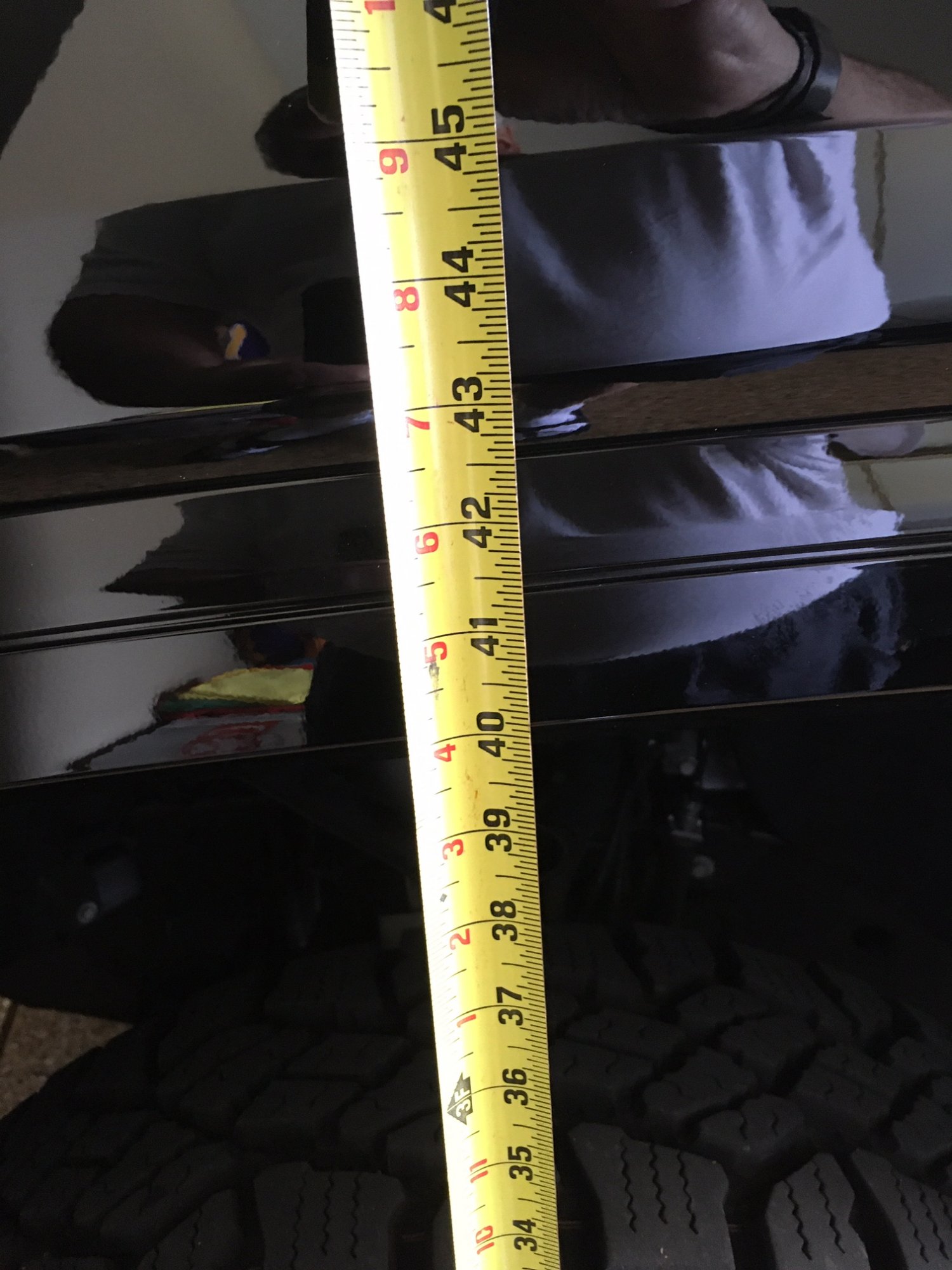

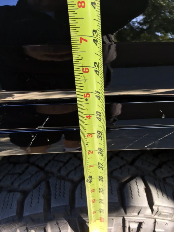

Supercup Posted July 30, 2020 Share Posted July 30, 2020 On 5/5/2020 at 5:49 PM, Casey Nelson said: 2020 AT4, Readylift 2” SST with only the front lift. Rear sits .75-1 inch higher as is. I don’t think I got 2” from the lift. I was at 38.5” from ground to the line where the plastic black fender folds in, centered on the hub. After, with stock wheels/tires, I was at 40”. Now with 33’s, I’m at 40.5”. Wish I had measured from the center of the hub. Anyone have any measurements on a non At4 stock? 2019 AT4 - 6.2 Carbon Pro Before and after photos below - similar measurements to you - I have OEM painted strips where yours are rubber - but about the same specs. Ready Lift SST - I was 38 before and 40" after up front and back 40" before and 41" after with new rear block added. Quote Link to comment Share on other sites More sharing options...
