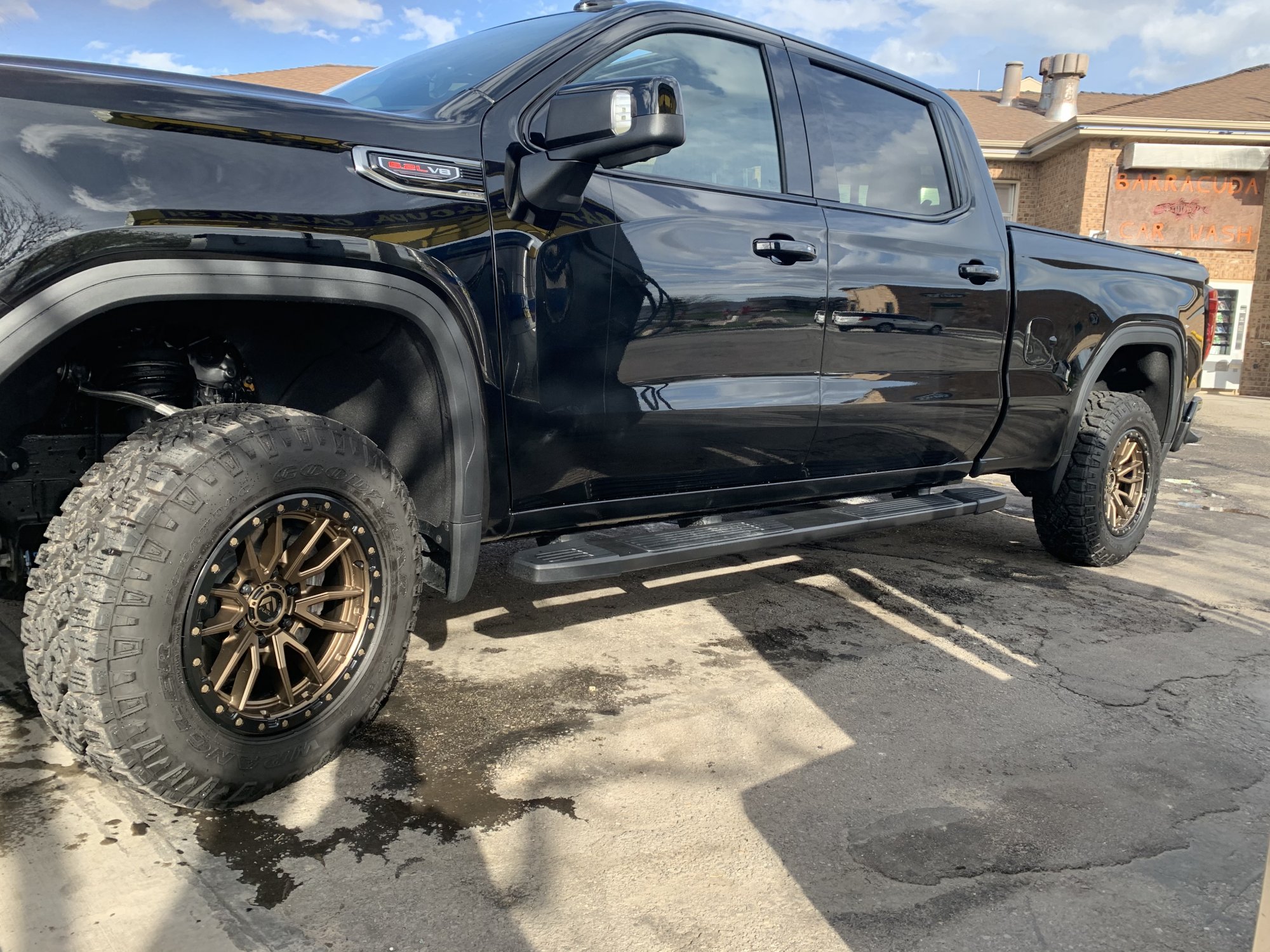

On 4/19/2020 at 2:47 AM, JSW74 said:
First photo (side view truck has the 2 inch Readylift) since been removed cause the boot contacted the bottom part of the strut. Added Rough country 2 inch leveling struts and the Readylift was removed. Plenty of cv axle clearance now  . 20x9.5 on 285/60/r20. It’s my vets truck. He said no rubbing and rides a lot better than factory. D2A65615-3C89-4782-86F7-4A8D688F9E79.thumb.jpeg.bd8df8bc931a278ae34cbc782ea8dd1c.jpeg

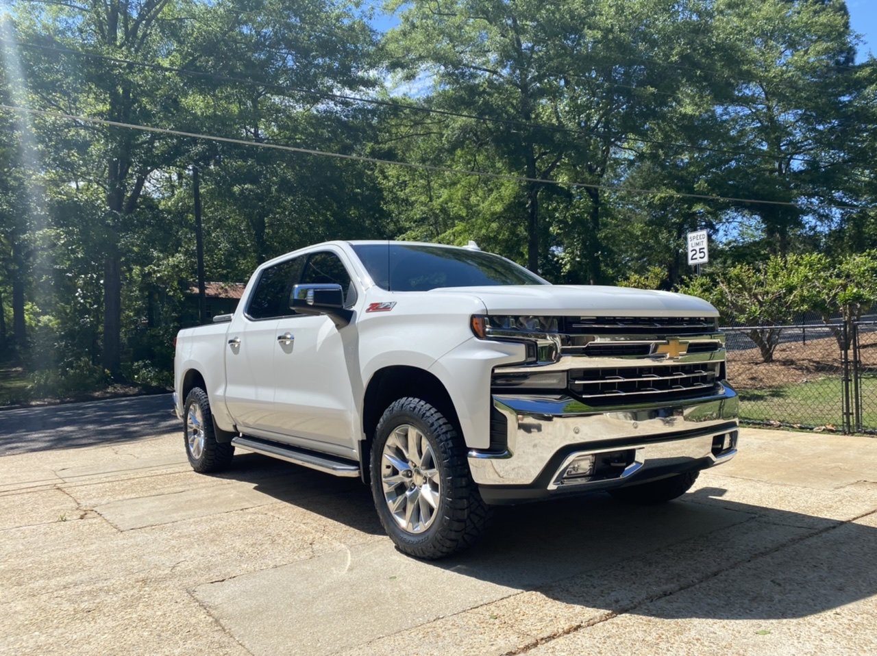

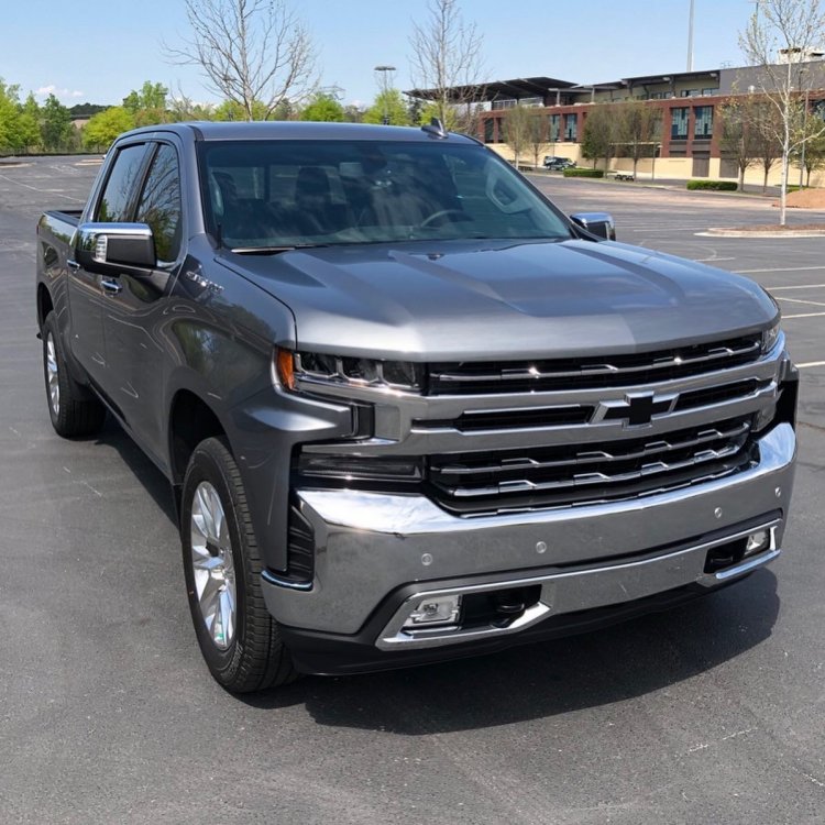

Looking to level my 2020 LTZ, and trying to find the best setup for the OEM 20” wheels. From what I gathered a 2” level kit on 295x65x20 should work. Has anyone noticed any significant issues with this setup? Any rub? My truck is pictured below. As far as leveling kits go, what is the best 2” kit? I want it to sit level to remove my rake.

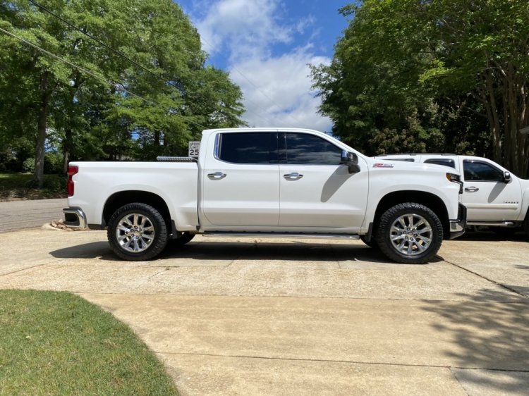

I’d be careful going 2” unless you plan on using a rear block. My LTZ Z71 had less than 1.5” rake. For the time being, I ended up just doing a simple 1”, then someday in the future, I’ll do a 2” front level with a 1” rear block.

That’s the perfect look! What size tires are you running? Also, I wonder if the Z71 has less rake? I have the standard LTZ 4x4.
