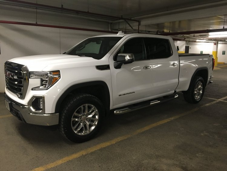

2” front level ,1” rear block
285/60/20 Toyo’s
Hey there. Any issues with rubbing with that setup? I want to do the exact thing.   I see ur in a parkade. No clearance issues? What type of leveling kit did u use?
Thx.

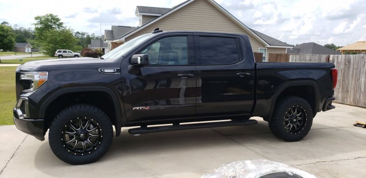

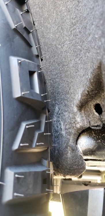

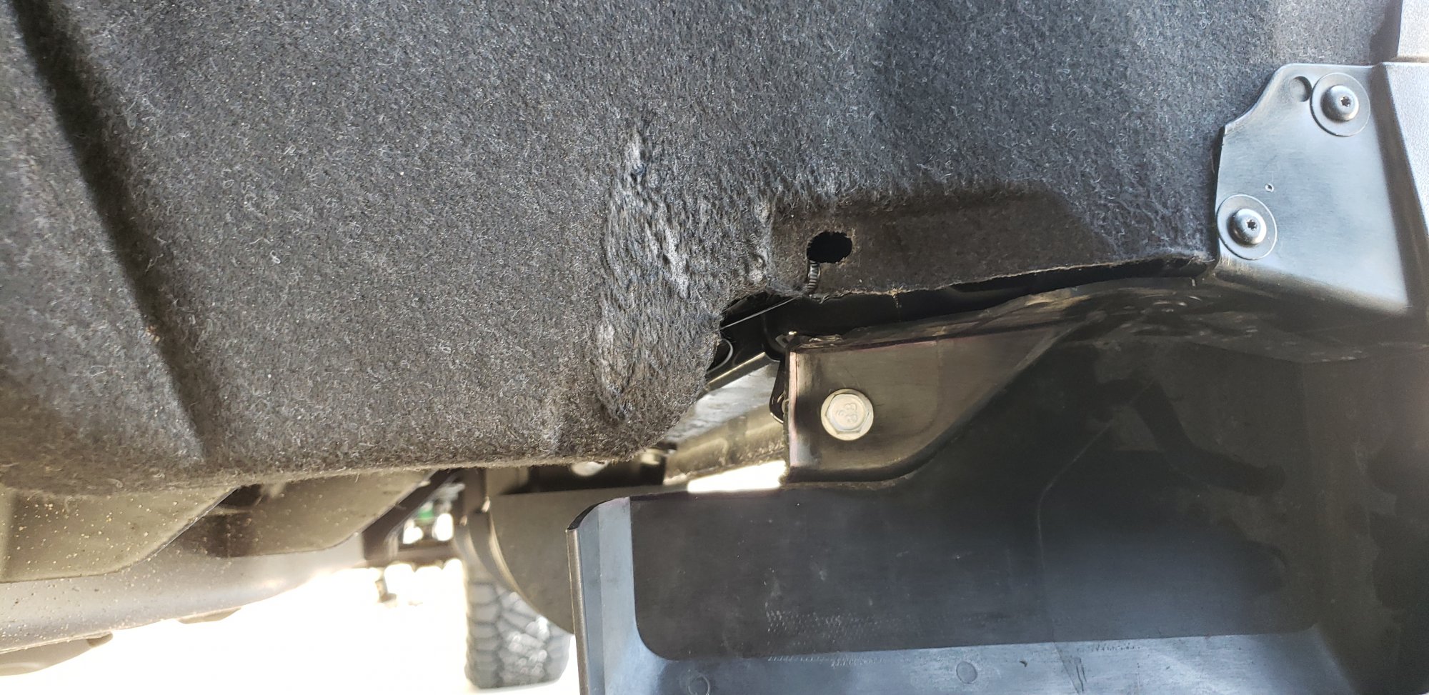

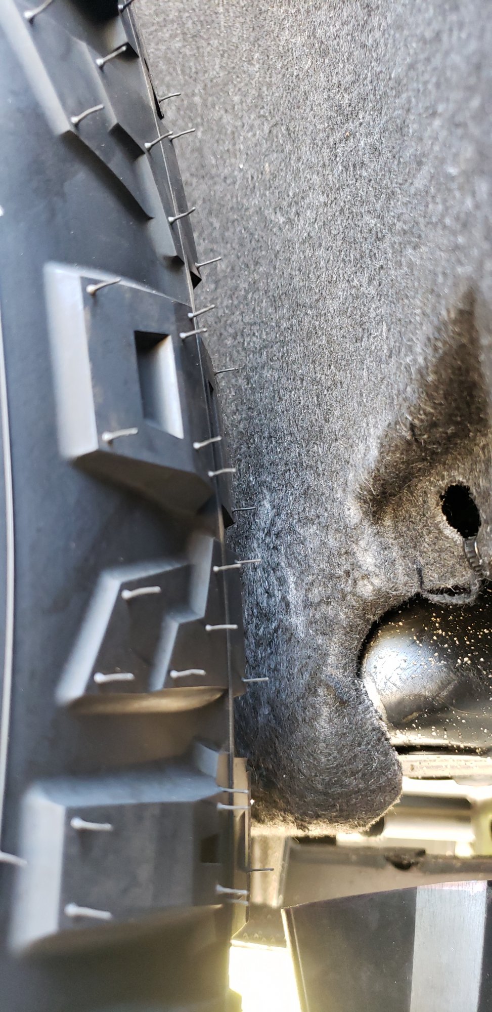

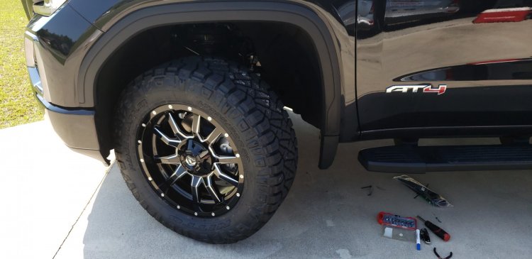

2020 AT4 with readylift SST front lift only, 295/60R20 ridge grapplers, 20x9 +1 offset fuel vandals. Mud flap mod will get rid of the rubbing. Only rubs at full lock in reverse.
I’ve been thinking about this size of tire but wasn’t sure how bad it would rub with my 1.5” level. Got pictures of your mud flap trimming?
Tire and wheel Combo look great on that truck.

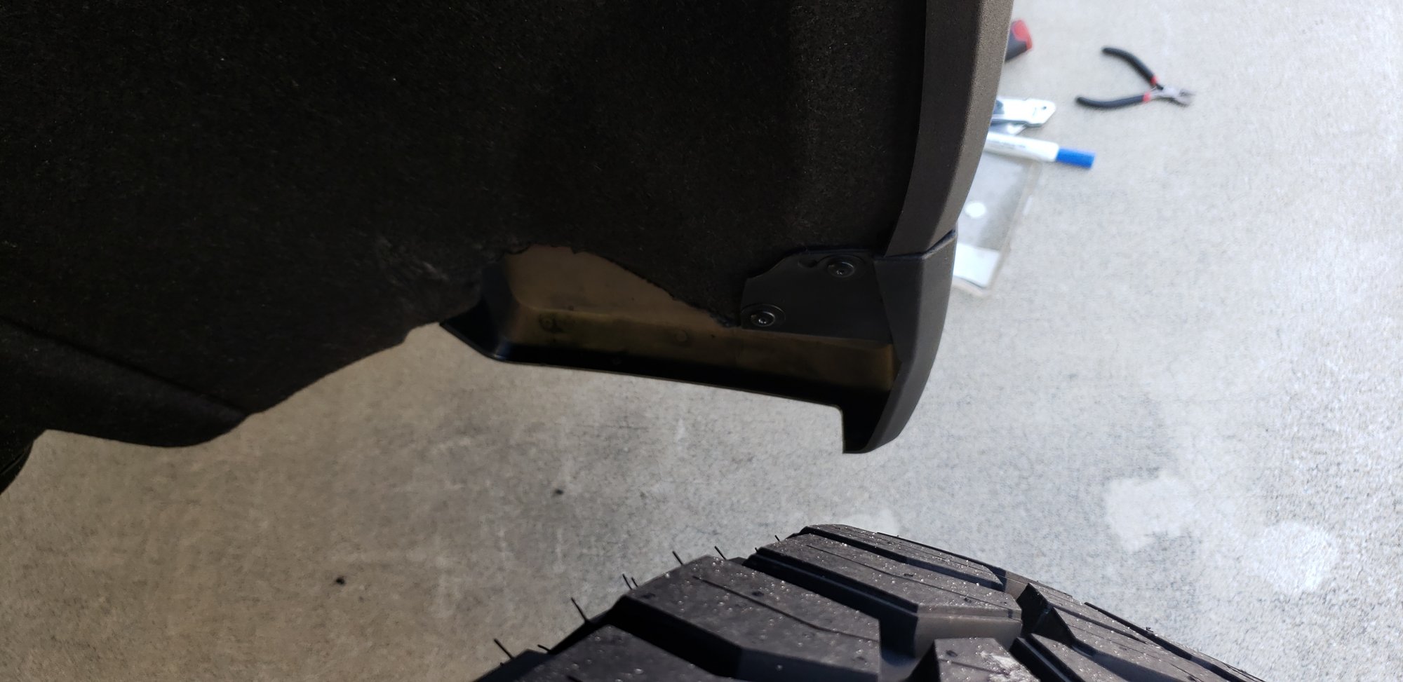

Thanks dude, I'll take some pics after I'm done. 1.5 I think would be pushing it. The SST lift got me almost 2" and it's a significant rub but not on the frame itself. Just removing the mud flap bracket got rid of it but I still want more clearance.

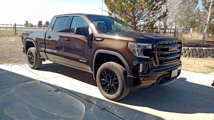

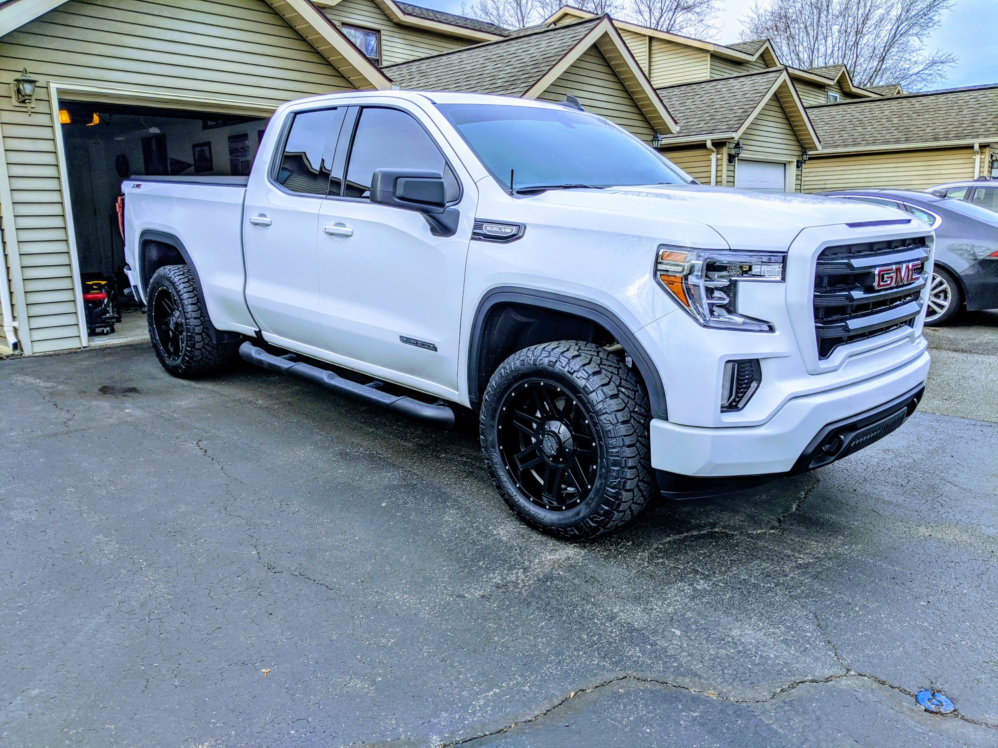

Here's mine.  2020 GMC Elevation with 2" AT4 OEM lift.  I wasn't happy with the feel of the front Ranchos so I replaced them with the Rough Country 3.5" lift struts, which gives me an additional 1.5" for leveling.

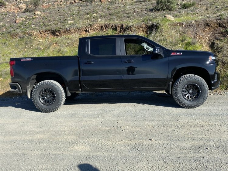

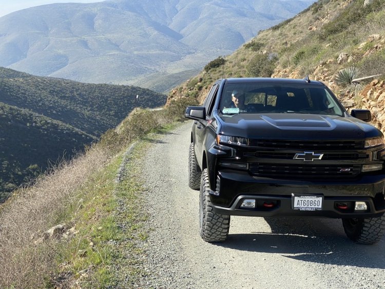

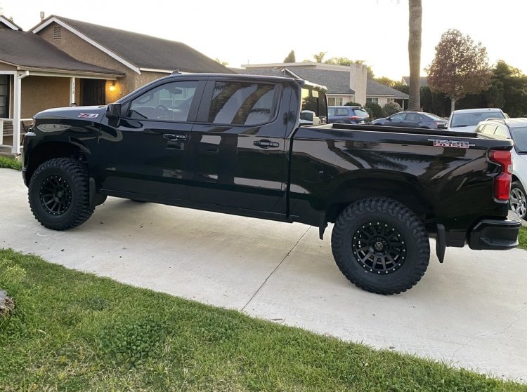

35x12.50r20 Yokohamas fit on a 2.5 inch level. But only just. Have to trim the the flap. But UCA's and sway bar are clear.
