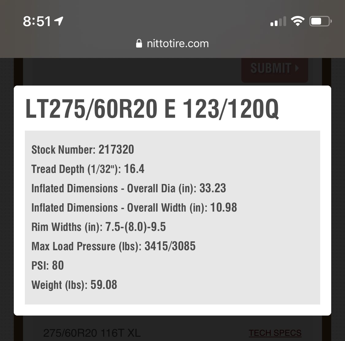

Basically LT tires are stiffer and heavier, but they have a higher load capacity. And sometimes the LT tires also look more agreesive because of deeper treads.
For the Ridge Grapplers, they make two 275/60r20 tires. One is the Non-LT and the other is LT. In my screenshots, for the same sizes, you can see how the LT version is about 12lbs heavier for each tire and how it also deeper treads.
295/65/20 is going to be a big tire. I don’t know if that would clear. But ive seen a guy on here with 295/60/20 and a 2” level, and it looked really good. I really like the look of the 285/60/20, but they only come in LT rating.

LT = Light Truck
P = Passenger
LT will be heavier due to its construction, stronger sidewall, better for towing and off road. Passenger a softer more comfortable on road ride but less capable towing/off road.

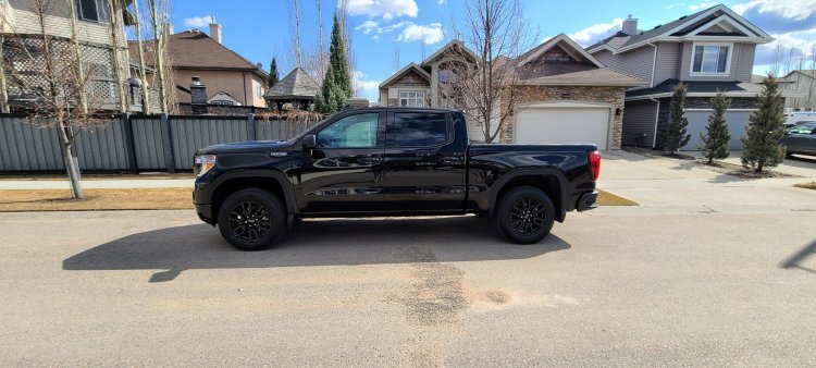

Just got the 2 inch Readylift level installed. Very happy with it. Didn't notice much change in the ride quality, which was something that I was worried about.
I want to keep the truck as stock as possible. Looking to add 1.5 inch wheel spacers and maybe change out the tires. Trying to stay away from a heavy 10 ply tire. I've ran Duratracs mostly, and had them in a 35" on my previous Ram. Any recommendations on a 285/60/20?

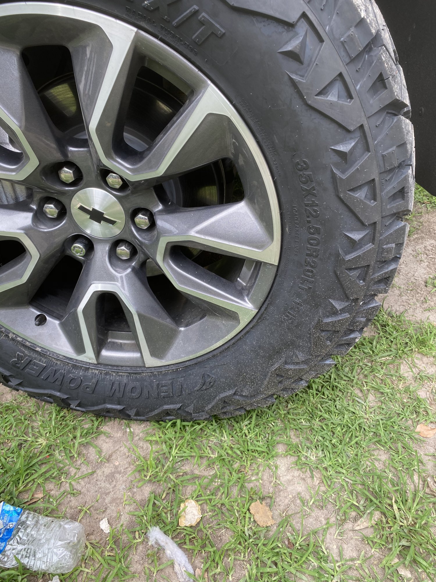

Here is my 2020 1500 4x4 Duramax. I have 2” Rough Country top coil spacer and 2”block on the rear with shock extension I put 35/12.50R20. I trimmed very minimal on the inner portion of the mud flap. Other then that i like the way it sits.
More photos please! Looks good though! I have the 2 inch Zone Off-road top spacer sitting in the garage waiting to go in just need a day off to do it !
