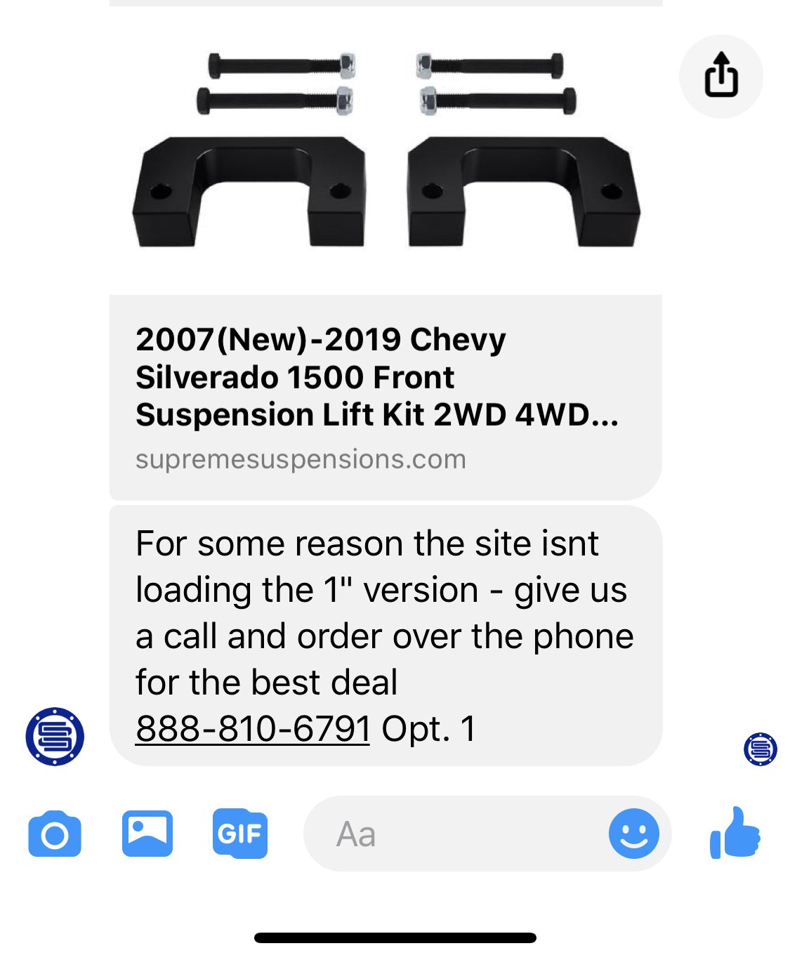

Supreme Suspensions also makes a 1” level,  but you have to call them. See my screenshot for their number...Only thing about supreme suspensions...their 1” is either silver or black, and they weren’t sure which color they had in stock...
