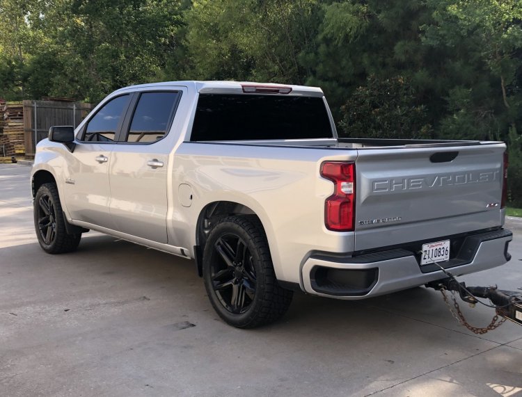

Anyone done helper bags? I put my wheels and tires on yesterday and have decided I’m going to level with a 1.5” rear drop using Wulf Suspension shackles for my 2020 RST.
I always have a trailer hooked up to the truck and I think I’ll def need helper bags to obtain a desired travel position.

Leveled my 20 Elevation, ready to fill those gaps with some new tires. [emoji2371]7d9b14dc44b9b965ff83b473a65fd95a.jpg

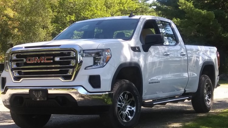

On 10/2/2019 at 2:38 AM, 2019 Sierra Me said:
Here is 3" kit on my 1500 Sierra. It now measures right at 40" in front and 42.5" at rear with the 33" tires,285/70/17" to the
Bottom of the wheel wells. Sits about the same as factory 2500HDs. Not even close to rubing anywhere. Rides and handles nicely. Get alot of " oh you bought a 3/4 ton?" Comments all the time. I am pretty sure 35" would have worked just fine. But I didnt want
to loose that much mileage.
