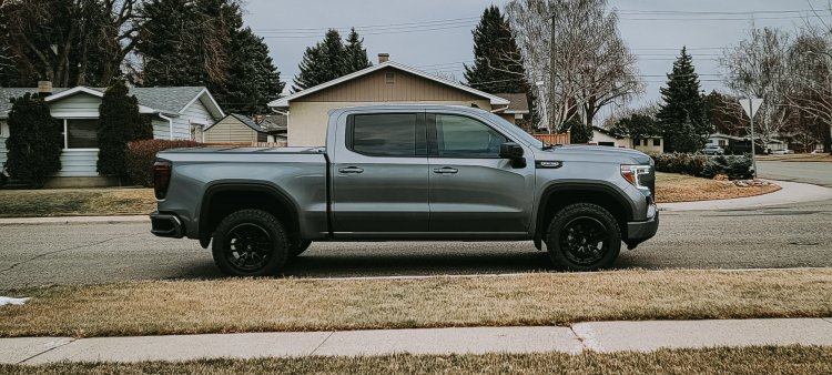

Got my dealership to install a 2" ReadyLift leveling kit. They originally added a 2" rear block as well (first picture) which I then had removed to get rid of the rake. (second picture) Distance from ground to fender is within 1/8" front to rear as it sits currently.
The fronts using under strut spacers?
22 hours ago, William Vis said:
Yes, the lower front strut extensions from ReadyLift
Did you manage to take your before and after measurements on this? I've heard it doesn't actually provide the full 2" of lift.
I forgot to take before measurements, but it's currently at 39 3/4 from the ground to the fender. Tires are a touch bigger than stock as well (275/60R20 vs 265/60R20) I agree that it doesn't raise it a full 2", but it sits level with the back now so that's ok with me.
