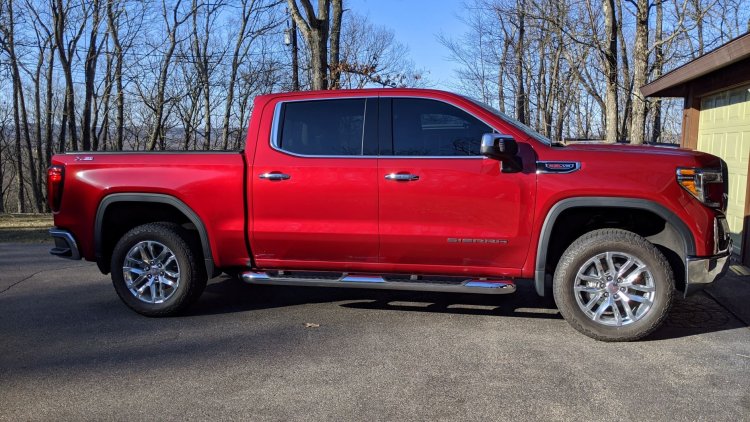

17 hours ago, Vmax08 said:
Changed out the Rough Country 2 inch bottom mount level kit for the Motofab 2.5 inch top mount level kit.
Already had the Rear spacer blocks from my 2014 Sierra installed.
What was the kit number you ended up buying?
I've read reviews that the Motofab kit doesn't fit the 2019's correctly.
Why did you change kits? Just the extra 1/2inch?
This is the kit I bought off E bay.
From Motofab website: 07-20 Chevy GMC Silverado / Sierra 1500 2.5" Front Leveling Lift Kit SKU: CH-2.5.
I emailed Motofab to ask about fitment and was told "may need to trim the studs a very small amount just enough to be below the spacer.  The directions are the same for the newer trucks".
The spacer for the 2.5 kit is 1.66 thick and I did not have to trim the studs. The biggest issue was aligning the mounting tabs on the bottom of the strut to the control arm as you have to rotate the strut 180°after installing the spacer. This caused the angle of the control arm & the tabs on the strut to be going in opposite directions if that makes sense. I saw where other top mount kits disassembled the strut and rotated the strut 180°. I assume this corrects the issue of missalignment. Just had it aligned today without any issues.
I changed based on all the talk of the clearance issues with the bottom spacer.
The extra 1/2 inch was a bonus!
