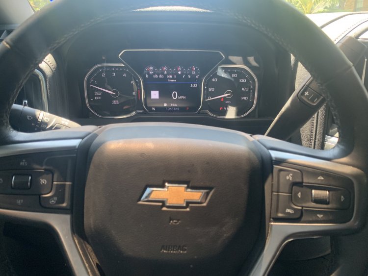

I was successfully able to swap out my Speedometer on my 2019 Silverado to the digital Cluster from a 19 Sierra Denali thanks to White Automotive & Media Services. It took a bit of effort to get to cluster out but looks Great. Highly recommended the swap

Looks awesome. . .  and like a very expensive endeavor
That's what I was thinking.
Very cool, OP!
For me, I don't think it would be worth the time or $ just to get the top 4 digital.
Plus, I think the Silverado dash looks better than the Sierra dash. :cool:

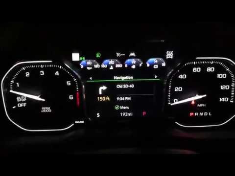

My Denali doesn’t have red/orange needles on the small gauges - blue level indicators in all 4. Doesn’t look bad but maybe should have used a High Country cluster just to delete that GMC logo on the lower right portion of the trim piece that goes around the tach. They look the same as yours, just more circular on the tach & speedometer.
Example of small gauges with blue level indicators:
Example of HC cluster:

They had it programmed for my Silverado so I’m guessing they used the gauges as the high and country. The Denali cluster was my cheapest option than purchasing a new HC one
That’s cool - all that matters is you’re happy with it.
Pretty amazing what those programmers are able to do to make the electronics work & change things up.
150 for the cluster and programming is 299 since it was used
