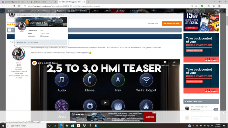

Something very exciting to share with you. A lot of people have been interested on whether or not this 2.5-3.0 HMI retrofit would even be possible in our older generation of trucks.
Well, I'm happy to say that the proof-of-concept is here for you to take a peek at :)
Like I mentioned in the video, there are still some kinks that we need to work out. Navigation is handled in a different way on the newer HMI than the previous version, and we're still testing access to other stock 2019+ vehicle applications (onstar availability, store compatibility, wifi hotspots etc.). But I'm happy to report that not only does it work on our test bench, but it also works in my 2014 (which I think is pretty sweet).
In regards to the new 3.0. Carplay and Android Auto are working as you'd expect, but they're faster and less buggy that with the old HMI's. the entire unit is just a nice face-lift and snappier to use all-around.Go test a 2019 Sierra and you'll see what I mean.
We are also working on some pretty fun unlocks and features for these units as well, so keep your eyes peeled.
I'm hoping to be able to offer a full retrofit kit for the new 3.0's in the not-so-distant future. There are a few things that need to be sorted, harnesses to be made, etc. to facilitate a seamless upgrade experience, but we're getting closer and closer each day and I figured it was time to share a bit of our progress.
Please, if there's any questions you have post them below. I'll be happy to answer ?
Thanks again for reading/watching. Feel free to PM me about any of your vehicle update needs.
