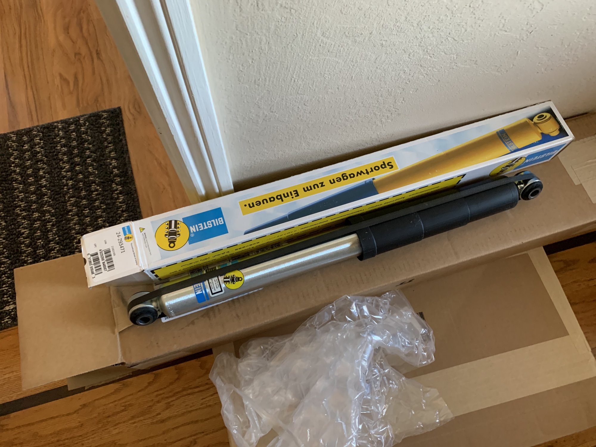

Edited by BlancoSilverado
** added more info**
