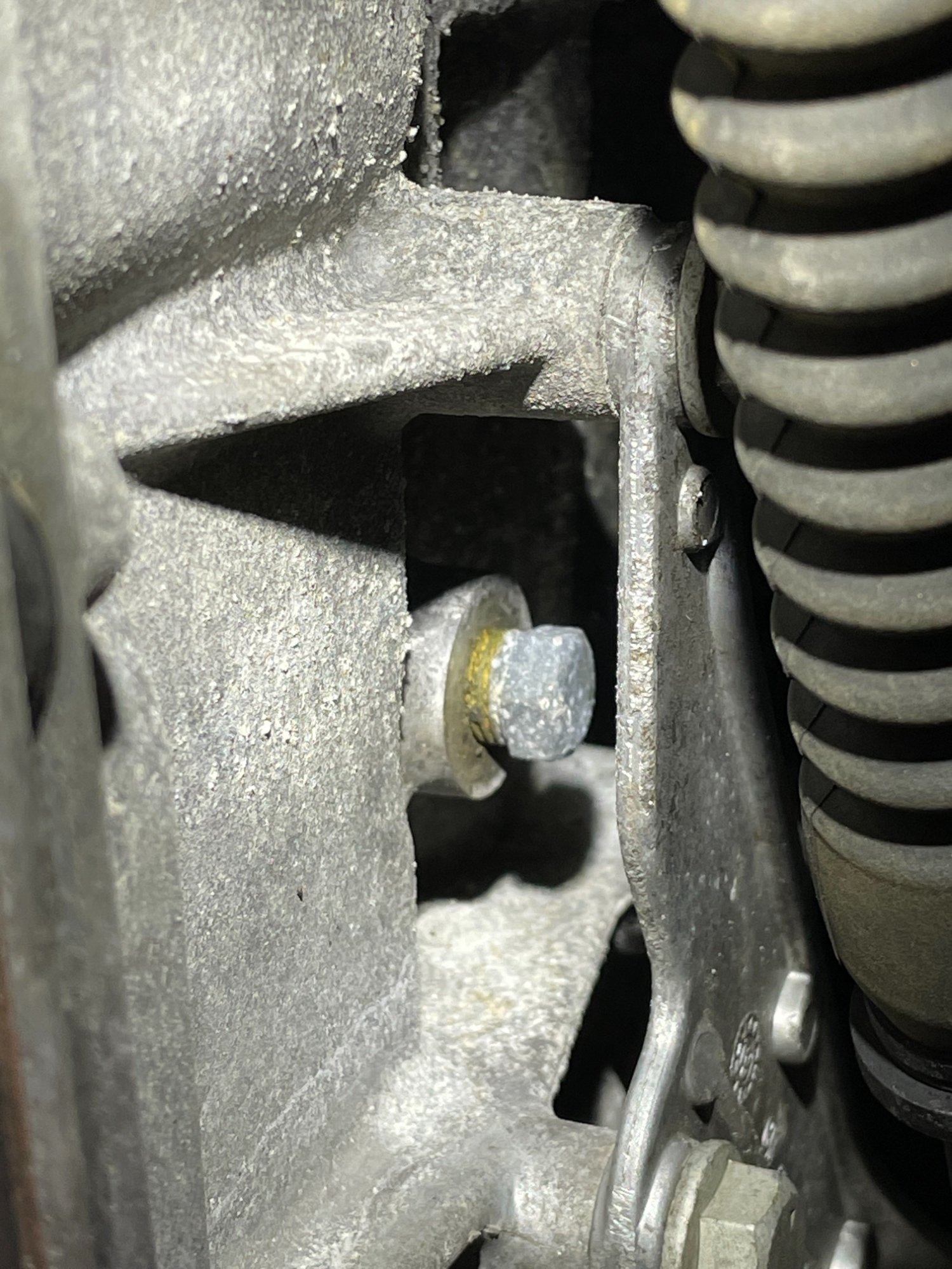

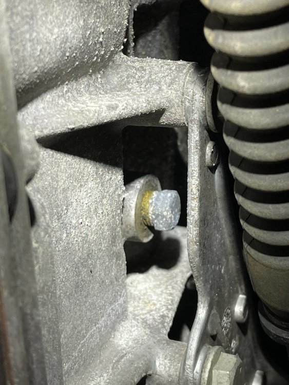

WHERE on the case? I see a 1/8" pipe plug1B48E385-6D4C-4675-8DF8-2C81B7E4B6BE.thumb.jpeg.e5bed608e40a0e37ab927cffce743da0.jpeg
I figure one of the reasons for 'dipstickless' is that they got tired of damage from owners that ignored / didn't know the correct check method and ended up with damage from the incorrect level.
Severe service maintenance schedule is still 45,000 miles for trans oil and filter change.
Edited by redwngr
What trans do you have??
