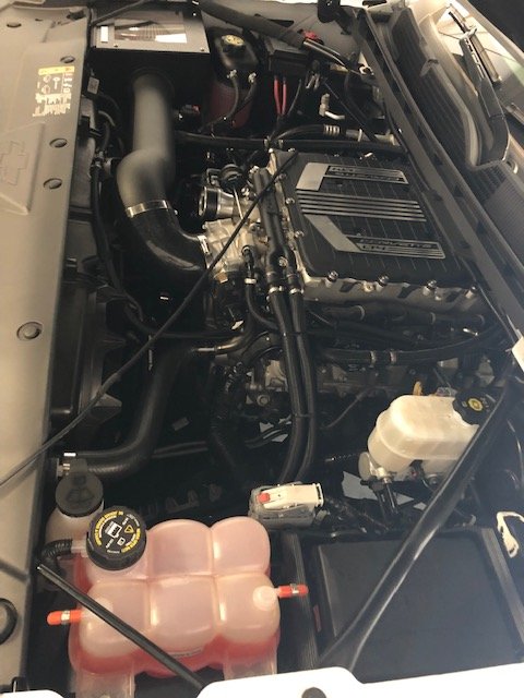

So there is a serious 2018 White shortbed  with a 5.3 liter L83/L84 crossbread engine an LT4 Supercharger running around Plano,Mckinney,Frisco area that makes more power to the tires than the new 2018 Zl1.
List of mods -
LT4 Supercharger
LT4 Throttlebody
LT4 Injectors
Lingenfelter Big bore pump
Hellcat Intank Fuel pump
ARH Headers -Black Ceramic
3.5" Custom Mandrel Bent Tig welded exhaust - Black Ceramic
Gmpp Intake System
L87 Accessory Drive
Vac pump delete
ADM Ethanol sensor system
ADM Performance Built and tuned
Mickey Thompson Drag Radials
Assassin Traction Bars
3-5 drop front and rear
Custom Pillar
Aeroforce Gauge
You running a stock cam? I'm running the same injectors and hpfp as you, but with a whipple on my l86. Is the hellcat in-tank enough fuel for the high side with e85? Beautiful build by the way!
