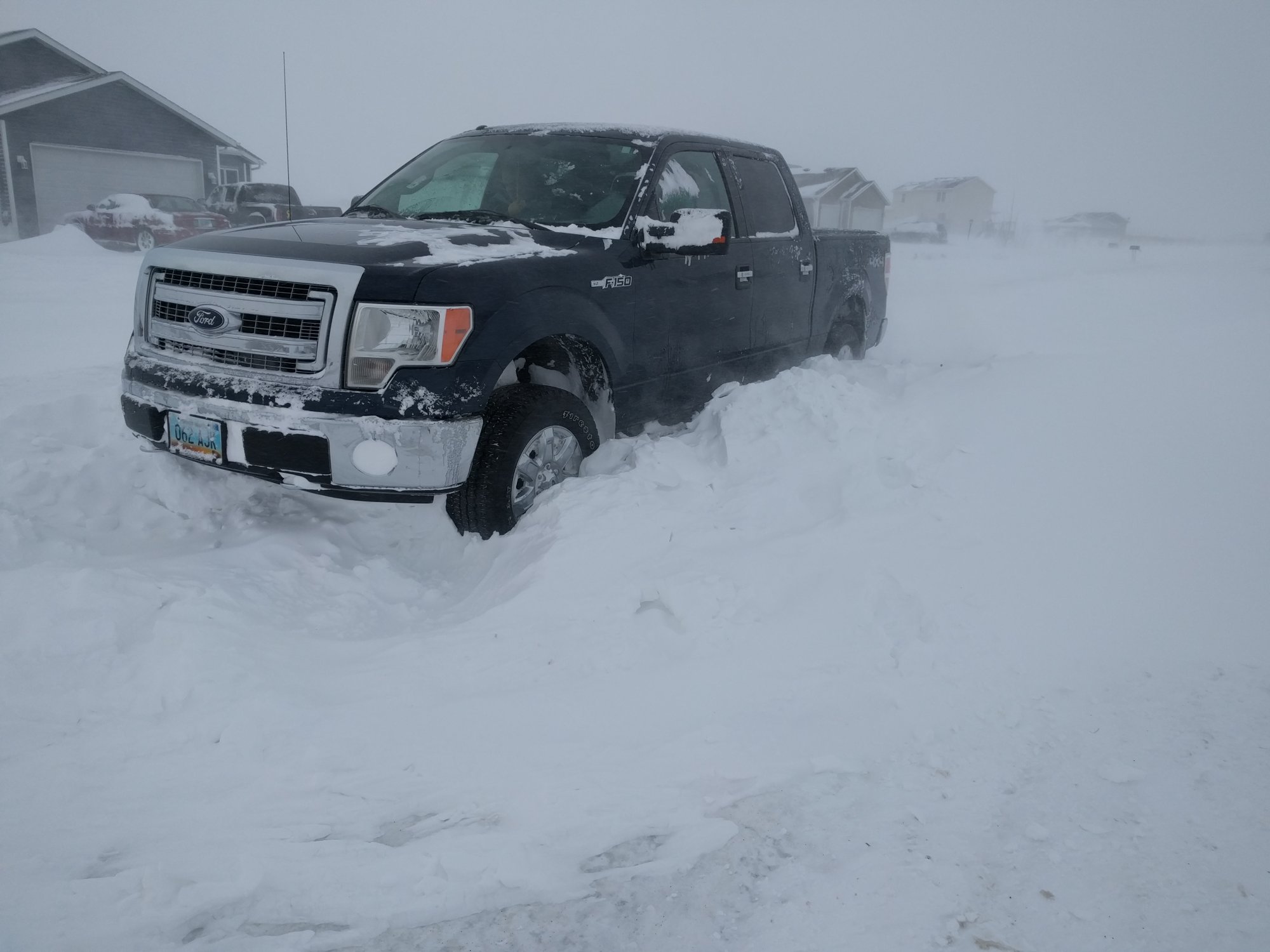

4wd will help you taking off but will do nothing to stop you. So on slick icy intersection instead of spenning the rear wheels forever u lock it in 4hi and zip through the intersection then back to 2hi. Never came across you have to engage 4wd every few months to prevented from seizing.but I never went more than 6months without using 4wd. I live in rural area and 2wd won't cut it most of the time. Big tall pickups get stuck in my area. I mean when u have snow drifts 3-6 ft high there is nothing you can do. Picture below is the proof ?

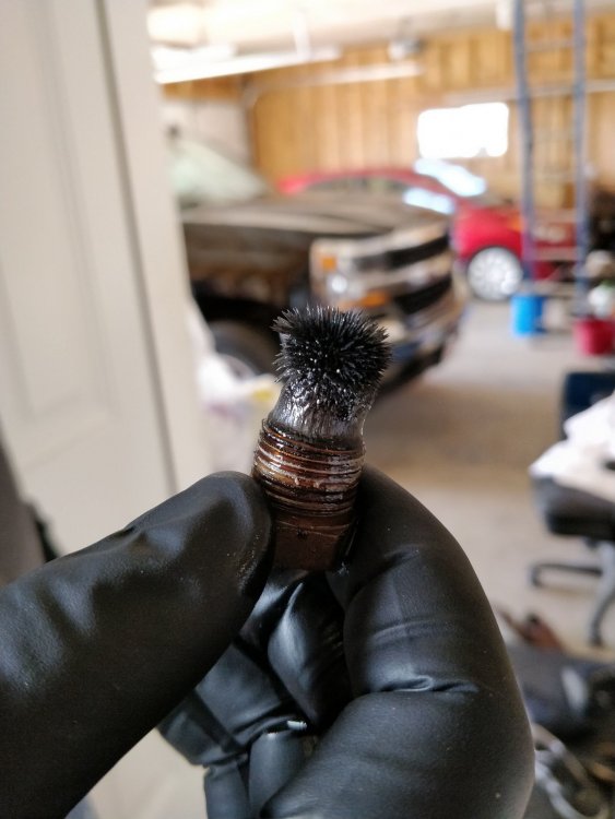

Yeah i am not sure my 2000 Silverado was horrible when I left it in auto. It felt like auto and 4hi were the same thing. When i put it in auto it never knew when to switch to 2hi and that is when I stopped using that feature all together. My dad keep his 2016 in auto prettty much all winter unless he is traveling on the interstate and when we did transfer case oil change the plug had tons of metal shaving which was double what was on mine with twice the mileage on mine if not more.
