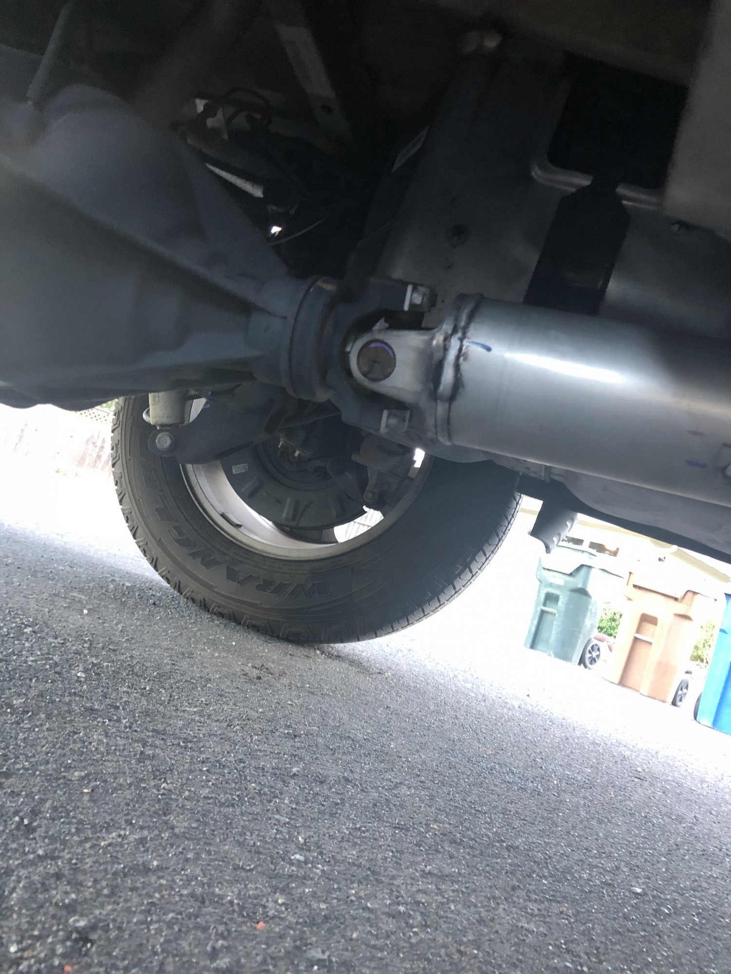

 Thanks! I have auto 4x4 so no need on that one. The splines though I don’t see any zerks... you are talking about ends of driveshaft at u joints right?
The front driveshaft splines go into the transfer case.  To apply new lubricant to it, you remove the driveshaft from the truck, apply lubricant, then reinstall.
Same with the rear driveshaft center splines (assuming your truck has a 2-piece driveshaft).  You remove the driveshaft, separate it, apply lubricant, reattach, then reinstall.
I would suggest not doing either of these unless you have the part out for some other reason, such as replacing the u-joints, or you are having a specific problem that you have narrowed down to those splines not being lubed.
Doug_Scott's mention of grease fittings are for u-joints, and your truck likely doesn't have greasable u-joints as GM has moved away from having grease fittings, as it makes the part slightly cheaper to not have them...  There are no zerks for applying lubricant to the splines.

My mention of grease fittings was specifically for the slip joints on the driveshafts.  Has GM not figured out that nickel and dimeing something that you selling for 10s of thousands of dollars is not the way save money yet?  Put than $0.39 part back in, and raise the price by a $1.00.  There, I just made you a 300% return on investment.  What am I missing here?  I realize that I have zero experience in saving money, but I have shitloads of experience in spending it.  That woman in charge of GM likely spent more for the clothes she wore to work today, than I have spent for the clothes I have worn this year, and if you toss in her purse and shoes, it will be very likely be what I spent for clothes in the last 4 decades.  And she gets the job.  Stupid part is, that is not the worst of it.  After likely 5 years, or maybe 10 years, she will qualify for a pension from GM when she retires.  Like she could not save enough from her pay to help offset the cost of not working.  Again, what am I missing?

The splines I am talking about are the ones on the front drive shaft.  If you follow the front driveshaft from the transfer case to the front differential you will find a shot where the driveshaft looks like it can get longer and shorter.  Those are the splines I am referring to.  Depending on the wheelbase of your truck you may have a 2 piece rear shaft, and in the middle you have those splines as well.  From previous posts here it would appear GM has removed the grease fittings that would make this greasing easier or at the very least possible.
