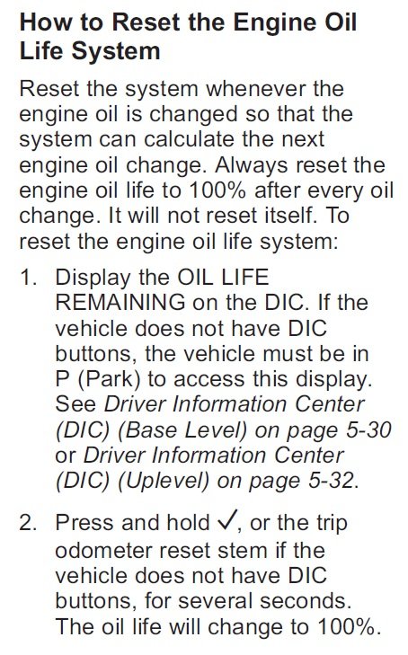

Oil life is not "automatically" reset. Someone has to do it.

Here's how to reset from my owners manual. I'd guess yours is the same.
go to oil percentage on DIC, right arrow over,reset should highlight, then touch your check button on steering wheel
