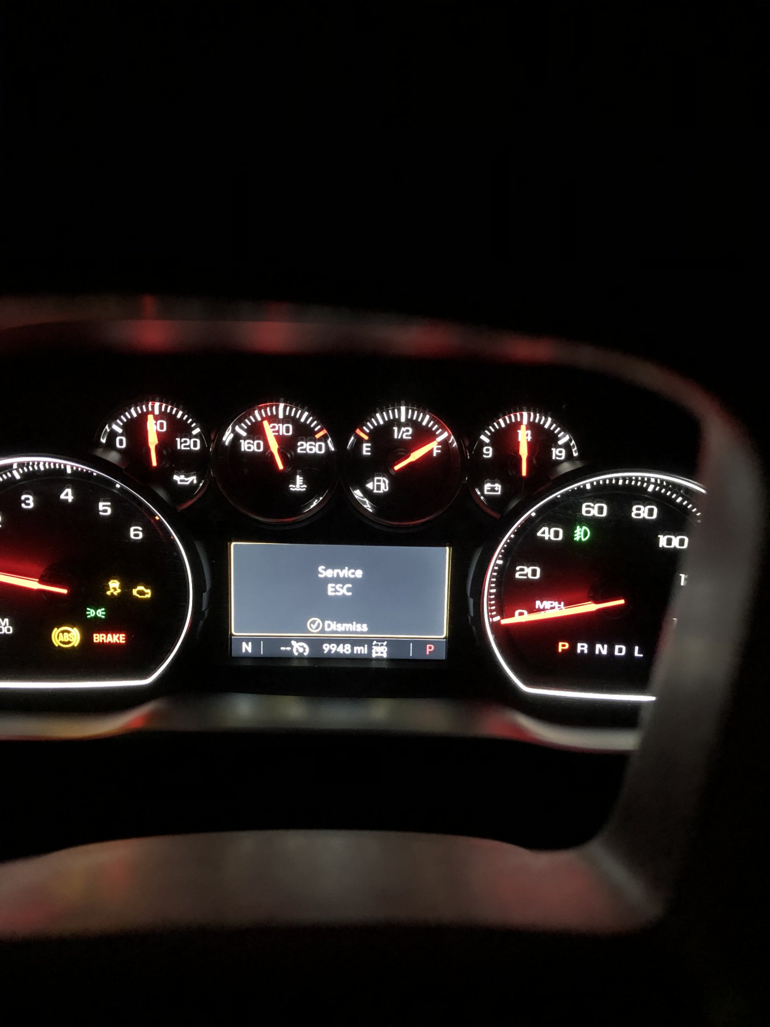

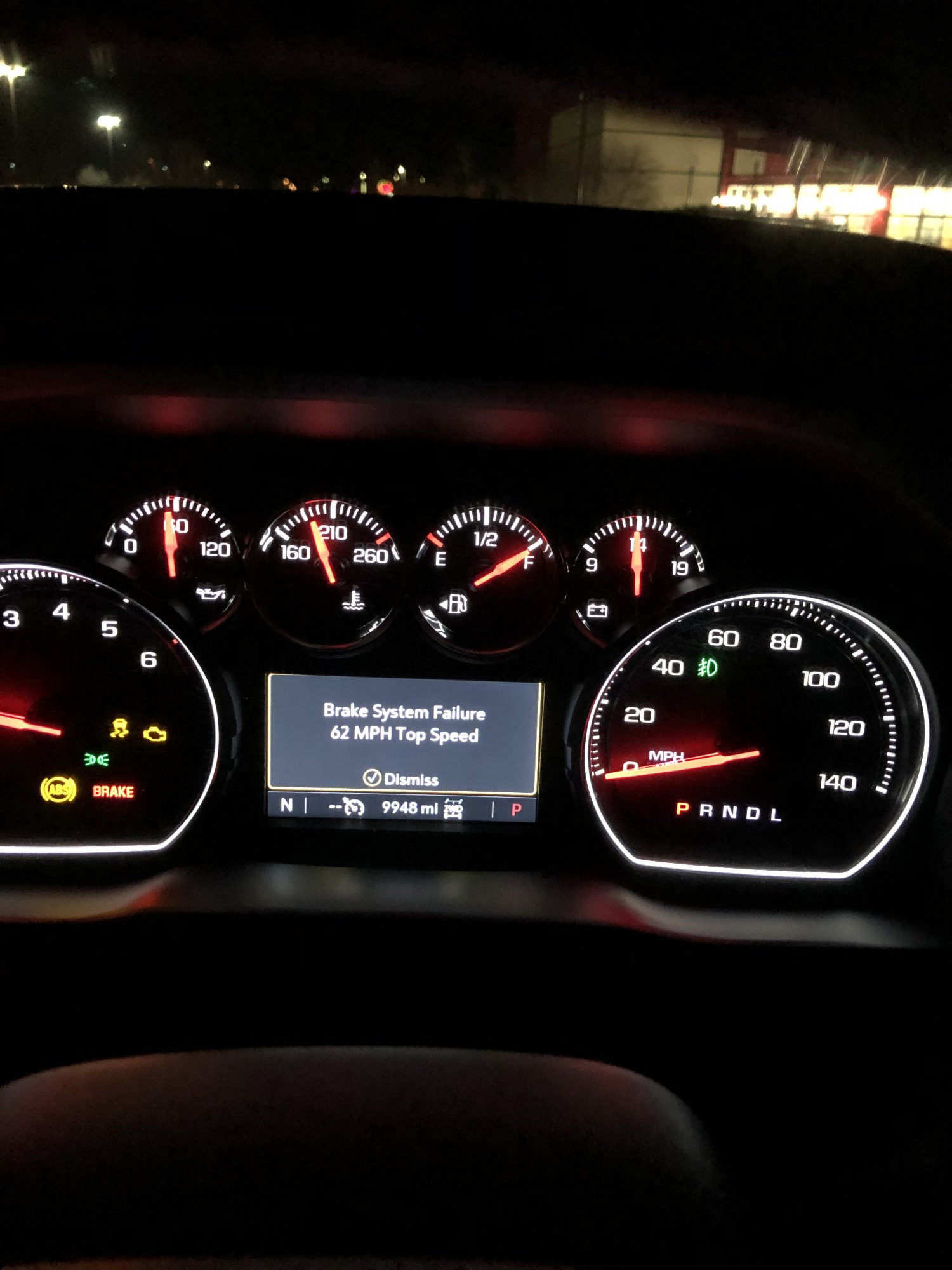

I had my 2019 LT Trail Boss serviced for the two latest recalls on Tuesday 12/17.
1.  Braking System
2.  Loose alternator cable
tonight 12/20 I had multiple braking system error codes light up my console.  Pics attached.  I attempted to drive down the street towards my house to see if I could ease home.  The brakes were stiff but got me home.  Very nervous and felt extremely unsafe.
GM is putting lives at risk!  I will be calling the Chevy dealer I went to on Tuesday first thing in the morning.  After reading this post, I am not confident they will fix the problem.  I saw where one of the posts mentioned getting a new truck. That’s where my gut is leading me.  I feel that GM should replace our trucks.  I can not believe we are having severe braking issues on brand new trucks.
when I got home, I turned my truck off for a few minutes and back on.  I did this twice.  The second time the brake service lights went off and the brakes felt normal again.  But the check engine light is still on.  Side note, one of the braking errors was also the trailer brakes.  I could only attach  2 pics...  Thankfully I am home, as it is too late to take to the shop.
I am extremely upset with GM...  And will not drive with my family in my truck until a resolution has been found!

How long after having it reprogrammed did you have issues? Had mine today and drove quite a bit with multiple restarts no issues
Left dealership, drove back to work and next start up the issues started. Now today we used the truck a lot and it’s every third start.
I’m taking the truck back to dealer next week and leaving there until they can fix it. Hoping to get a loaner - sucks but I can’t trust this thing. It’s a safety issue.
