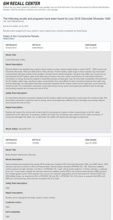

To those that are having the recalls done,  do the recalls actually show up for your trucks, or are you just taking them in as a precautionary step. Im asking because no recalls show up for my vin.  Mine was built in 6/19  5.3 sierra. Just wanting to make sure im good by not taking it in.
I have been notified in my Chevy Owner Center site about all 3 recalls.  https://my.chevrolet.com/home
