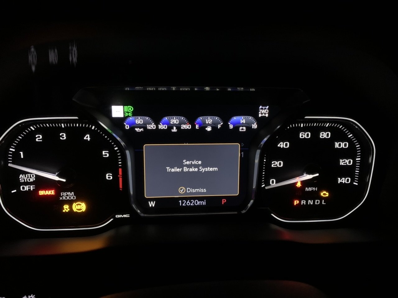

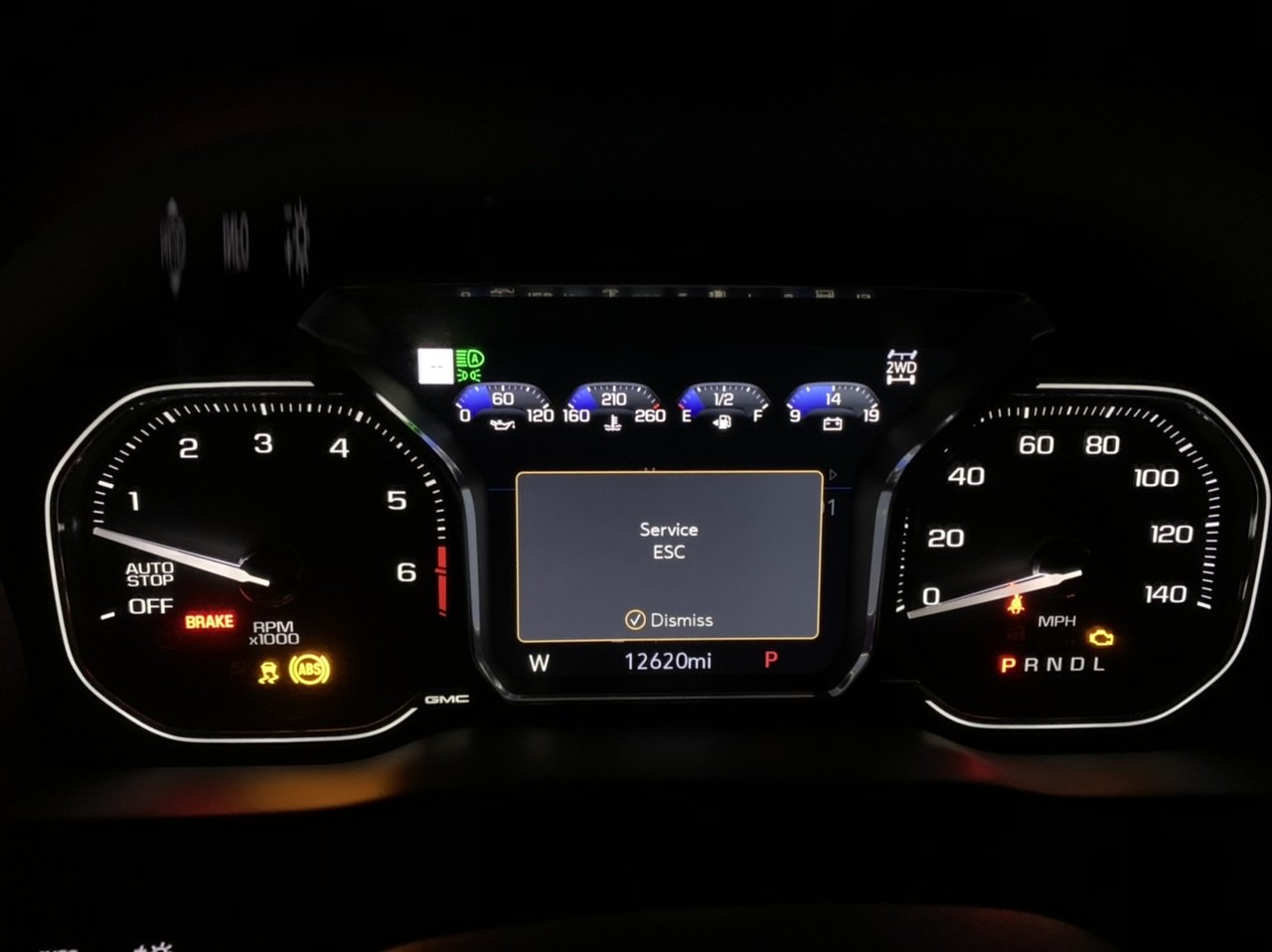

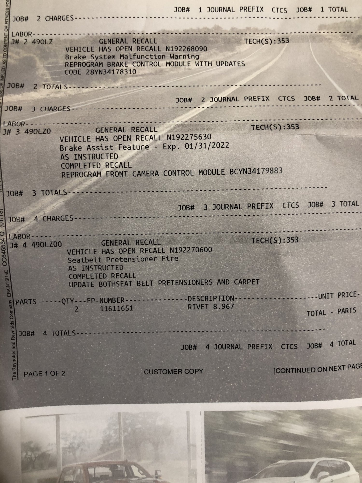

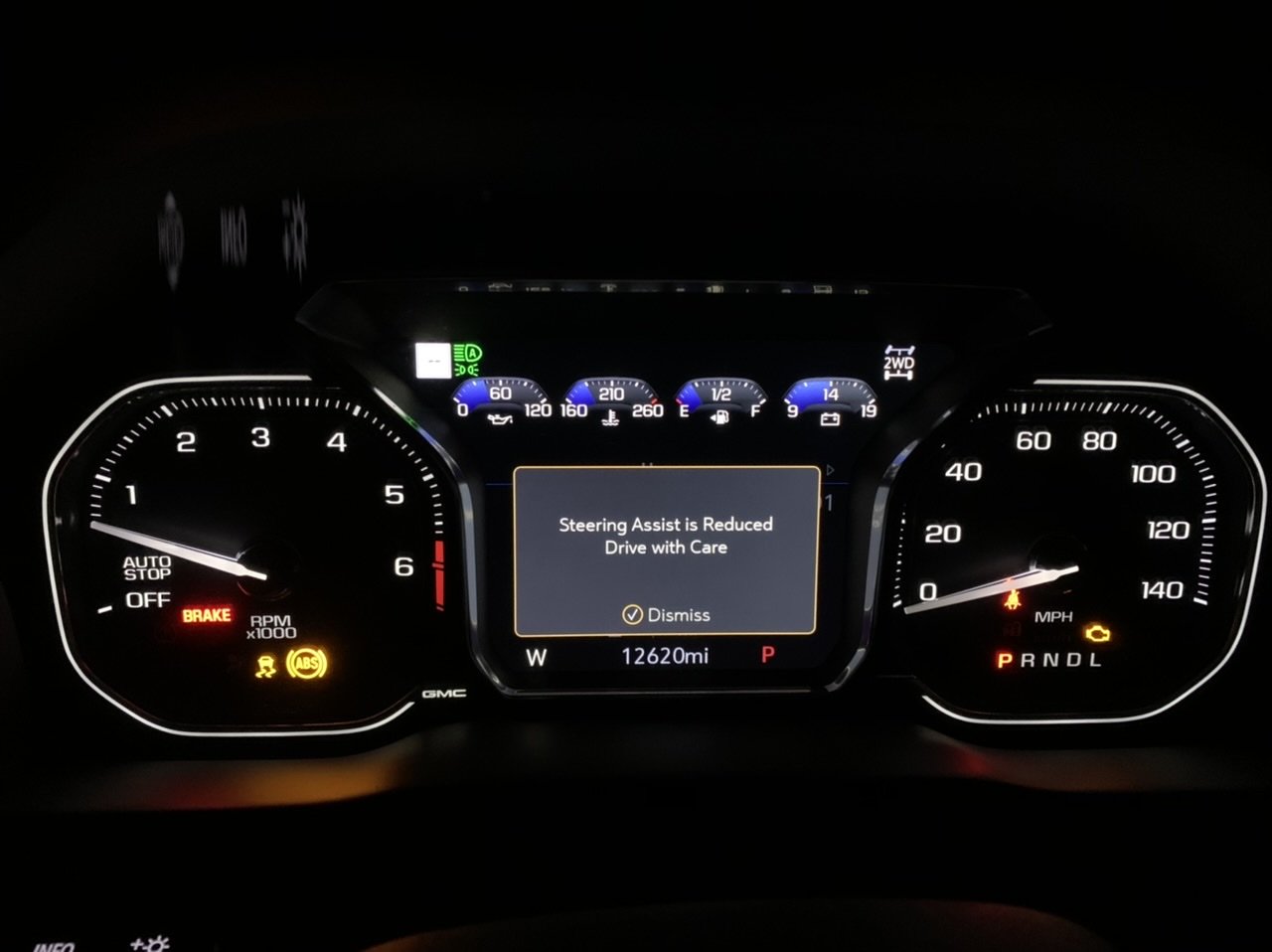

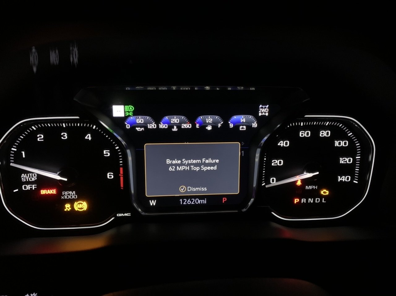

Never had any brake failures, or issues with the ABS since I purchased, only the 14% pad life issue and a leaking rear window was the reason why I took it in mid December.  Had all three recalls done.  When picking the truck up, I noticed that all the forward camera related safety systems weren't working, ie lane departure, forward collision braking, intelli-beam, pedestrian braking etc.  None of the icons or the button would work.  Took back to the dealer over the Xmass holiday to look into it, and was told after 2.5 hrs that they weren't able to resolve and need input from GM.
Over the last week, some of the systems started to come back on their own, I was getting forward collision warnings, the little car icon popped back up on my HUD and dash, and the lane departure button was illuminated (not able to turn off now) but the lane departure icon stays white (not working).  This past week I felt this was kinda promising that some of these features were perhaps resolving  themselves.
That was until today.  Remote started the truck from the app about two hours ago, went to get into the truck and notice that even before I hit the start button that the CEL was on.  Hit the start button and bang,  four errors cycle through the DIC, reduced braking / speed 62mph, ABS failure etc.  All the goodies.  Hit the start button to shut down and start back up and bam, no error codes, just the CEL on now.  Drove for a bit and everything seems ok, just the CEL on.
Have owned GM trucks since the late 90's, never have felt that I couldn't trust the vehicle I am driving like I do now.  Have three kids and honestly unless these brake issues aren't resolved, will keep them out of the truck.
