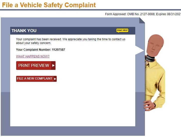

I just filed a complaint with: NHTSA - National Highway Traffic Safety Administration.  Feel free to do the same here: https://www-odi.nhtsa.dot.gov/VehicleComplaint/?
I filed a complaint with them as well, I am also pursuing MD state Lemon Law with them. Considering there is currently no fix for a brake issue I am beginning the long process of a buy back.
