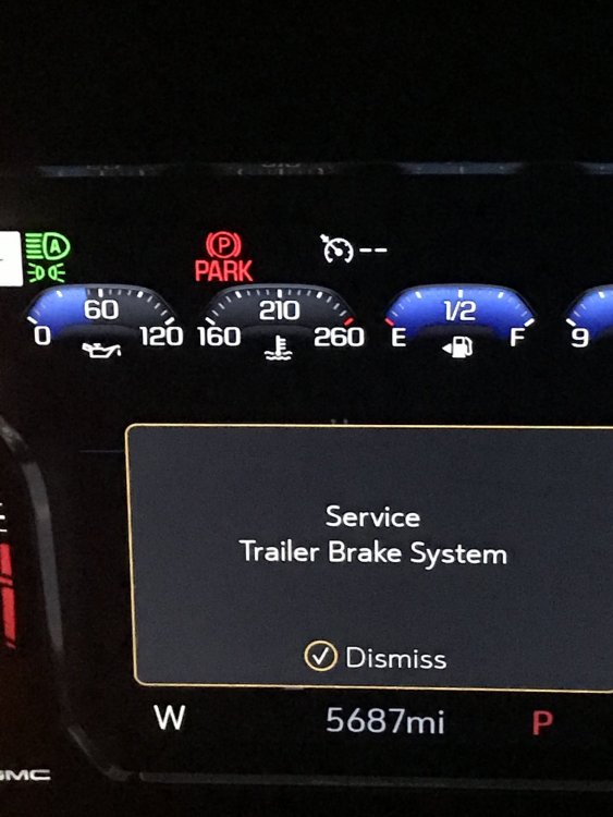

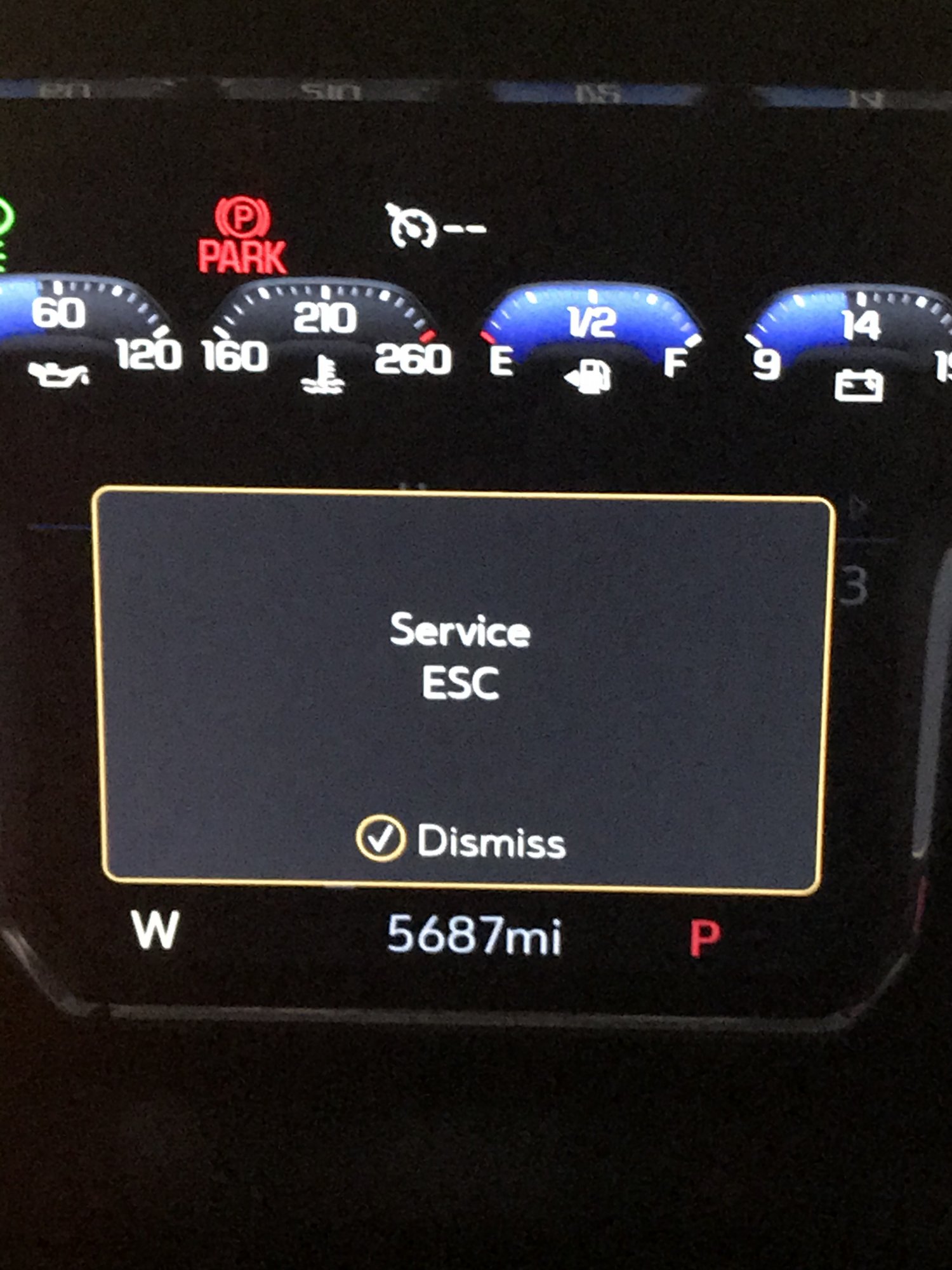

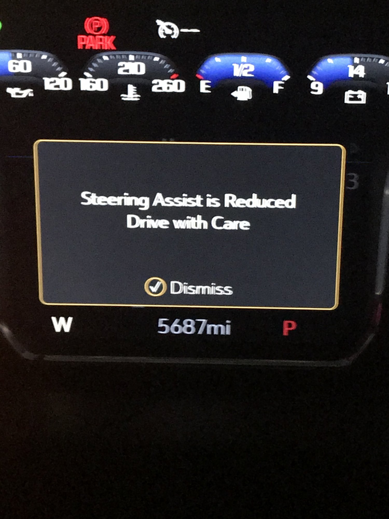

Well I was doing well.... then I took it in for its first service and told them I am getting some hard shift 1 to 2.  Pick it up and all seems well. Next day get ready to go to the store and all there errors showing up, including some ECM codes.

So I literally just went through my first tank of gas with my 19 elevation.. 900kms on it. Went to go drive and engine light was on - called on star they said it was code P25A2 and U0101/U0100/U0146.
I noticed some brake pad wear already gone and I’m not even at 1000kms. Same with oil at 73%.
on-star set up an appointment with local dealer.  What should I mention to them or make sure they do so I don’t incur any of these brake failures while driving. Kind of worried to take it into work tomorrow before going to dealer... should I let my brand new 60k truck sit?
