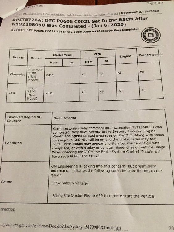

It seems GM has come out with a software fix to address the Remote Start feature thru Onstar which affects braking. PIT 5728B is the new TSB.

Have you had the recent Recalls completed on your vehicle? Did you happen to remote start your vehicle with the Chevy/Gmc Myapp? If so GM has a recent software update to hopefully address this situation in PIT 5728B.
If you haven't had these recalls completed, ensure the dealership knows and ensure they get everything done along with the PIT5728B bulletin.

Can anyone post the details of the PIT5728B bulletin?  Wasn’t able to find it via Google maybe too new or it is not publicly viewable?  Sorry, I’m new to this so I don’t know how that works.
Just scroll down.
  • Thanks 1
