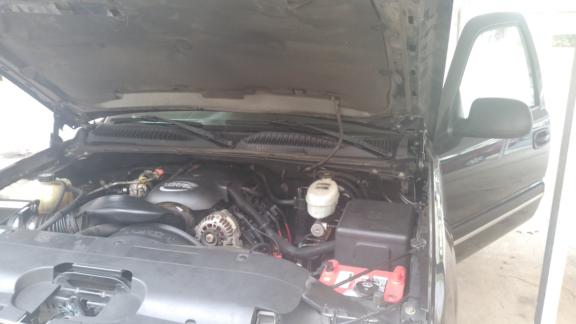

Thanks very much for replying. I managed to get the new hood spring hinges on with the old 3 bolt supports. When the hood flew back it bent the heck out of the spring lift hinges, the supports survived with minimal bending. I ordered 2 new lift hinges and 2 new supports so your instructions are what I needed to the the T. So I guess I have some new hinge supports for whenever I source a replacement hood down the road.
You are greatly appreciated. Glad you understood my writing which was all over the place.
Attached a pic of the hood lifted without my broom stick. I'm a happy country boy. IMG_20200221_121517708.thumb.jpg.12834cdf57271ae6dca364f2d6c61870.jpg
Much obliged.
