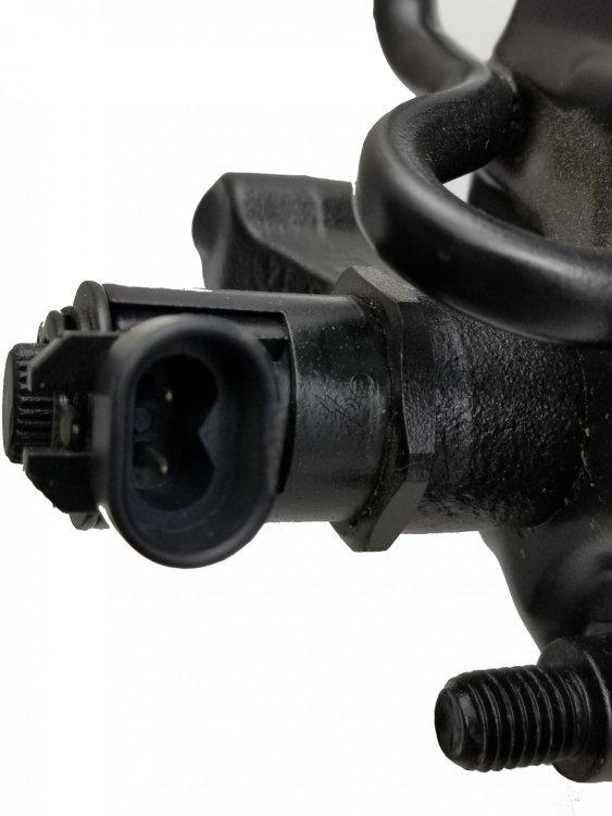

99 k2500 truck 7.4. Problem.  #1- have to turn over for a couple seconds to start 50% of the time other 50% it fires up at the bump of the key. #2- idles pretty good but 40% or more loud pedal it starts to misfire. #3- 52/53 psi on the fuel rail. Replaced fuel filter but not the pump yet. Replaced the bank 2 down stream O2 sensor for a lean code that autozone ran on it. Still no change. A while back I recently replaced the power steering pump and went with the evo conversion piece that gets rid of the sensor piece (hydro brakes). I’m wondering if that sensor no longer hooked up might be causing the problem but as stupid as it sounds I wouldn’t put it past this truck. Really hate to get rid of it since it’s a rust free straight clean body obs crew cab 4wd but patience is wearing thin. Any idea on what may be causing this problem. Thanks. And it didn’t start doing this till I replaced the power steering pump. Just throwing it out there is all. One image has a stainless line that deletes the hose attachment piece that has the sensor. But I’m thinking I should have 60psi on the fuel rail.
