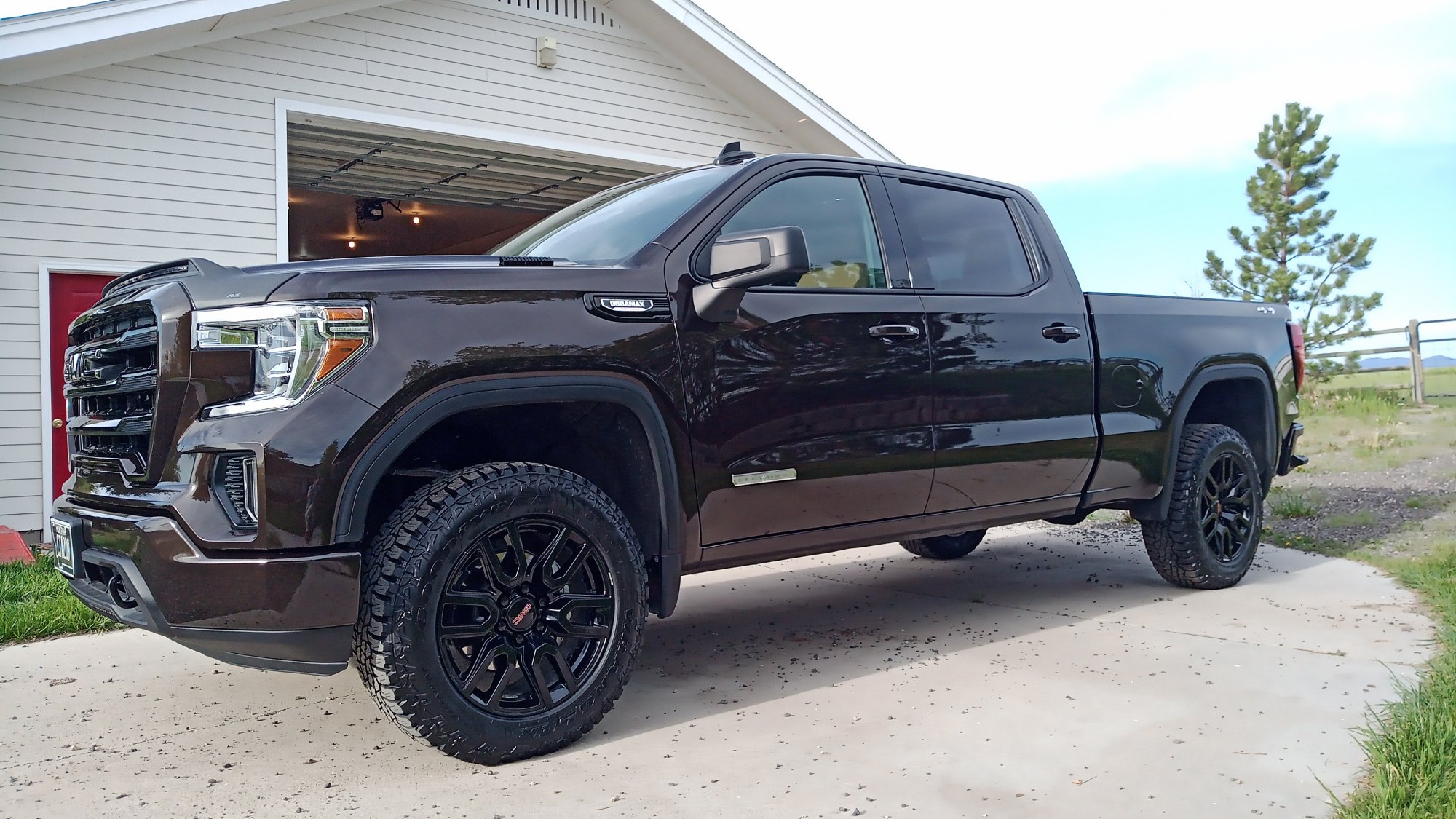

Kchampagne Posted May 31, 2020 Posted May 31, 2020 I did my truck this weekend with Adam's Polishes Ceramic Coating Kit. It came out awesome. Very happy with the result. Couple of tips:. Take your time, clean with microfiber towel and isopropyl alcohol, work in small sections, don't let it on too long (as soon as it rainbows, buff it off), use the UV flashlight to ensure coverage and overlap. I got my kit on Amazon. I am really impressed with Adam's products. Great customer service too. Here's the kit I bought. https://www.amazon.com/dp/B07ZDKLZ2F/ref=cm_sw_r_apa_i_B2c1Eb712Q7XH
