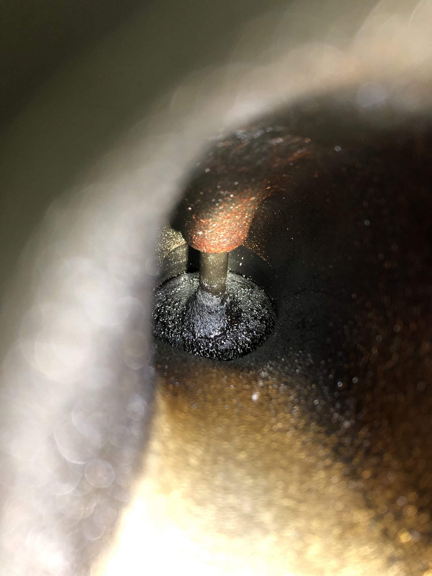

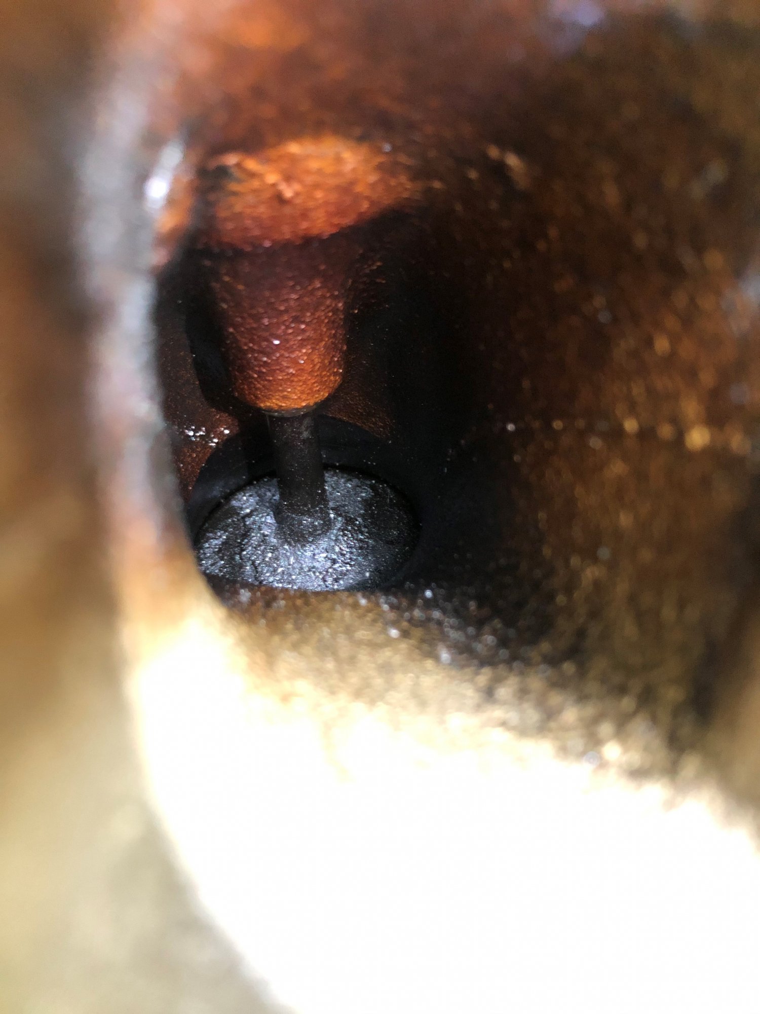

Saw gone_fishing post pictures of his intake valves at 30,000 miles. Thought I would show some photos of my valve deposits at 100,000 miles without a catch can as I was curious myself. I was experiencing a pretty rough and intermittent idle a few months ago (shaking the truck kind of rough) and put a can of sea-foam through the intake. This worked for approximately 5000 miles but eventually returned. I took the intake manifold off to give things a look and as expected, intake valves (photos of only ports 1 and 2) aren't looking so hot. Planning on walnut blasting or manually cleaning when things warm up, still -25C (-13F) here in Alberta.
That's not too bad to be honest, looks fairly good.
It hasn't been warm enough for me to take my intake off yet but I will be here in a few weeks when it warms up. I'll have over 104k miles on mine by then with no catch can. I run E85 on and off now so I wonder what mine will be like.
Definitely worth a walnut blast on this valves.
Good thing about our intakes...only takes 20 minutes to remove...another hour or so blasting the valves and another 20 minutes on the install. Not bad considering it’s probably only necessary to do, every 100,000 miles or so.
Not seeing anything in those photo's that gives me pause. Sorry. I've seen worse in the 60's with carburetors.
I wonder what it would have looked like without the Seafoam treatment.  Was the recent treatment the only time any chemical cleaning was done?

Honestly doesn’t look too bad for that mileage. Thanks for sharing ?
Hoping that the walnut blast/manual clean will improve the idle once completed - been chasing it for a long time!

Yeah just once! I was expecting it to be worse in all honesty - maybe this had something to do with it.
