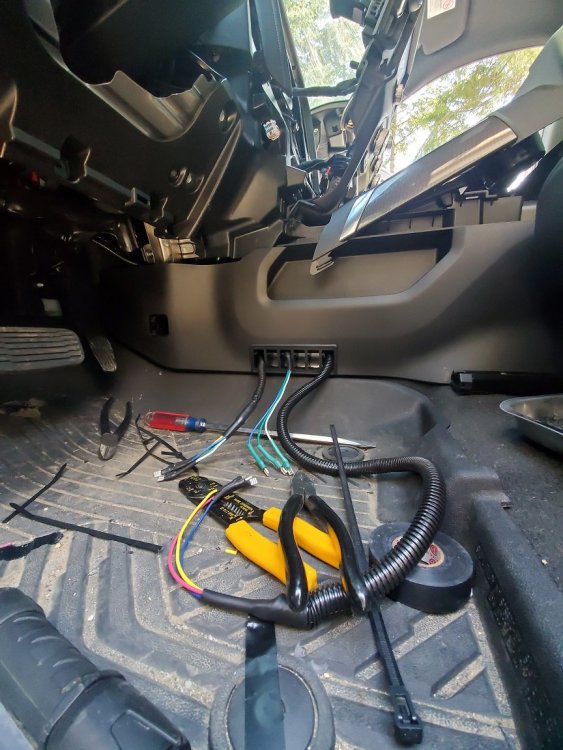

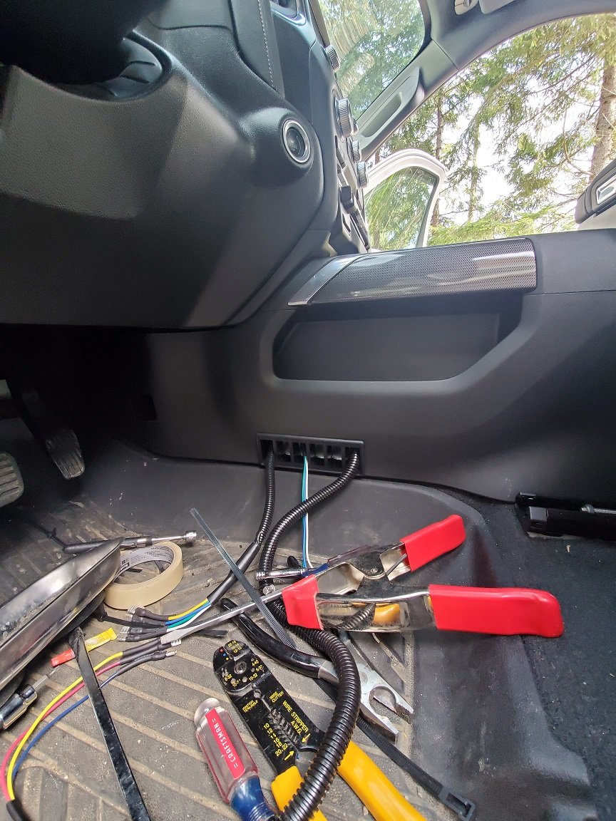

Update, the truck is reassembled now. Still waiting for some fabricated items so I can place the lights but the interior is just about done now.

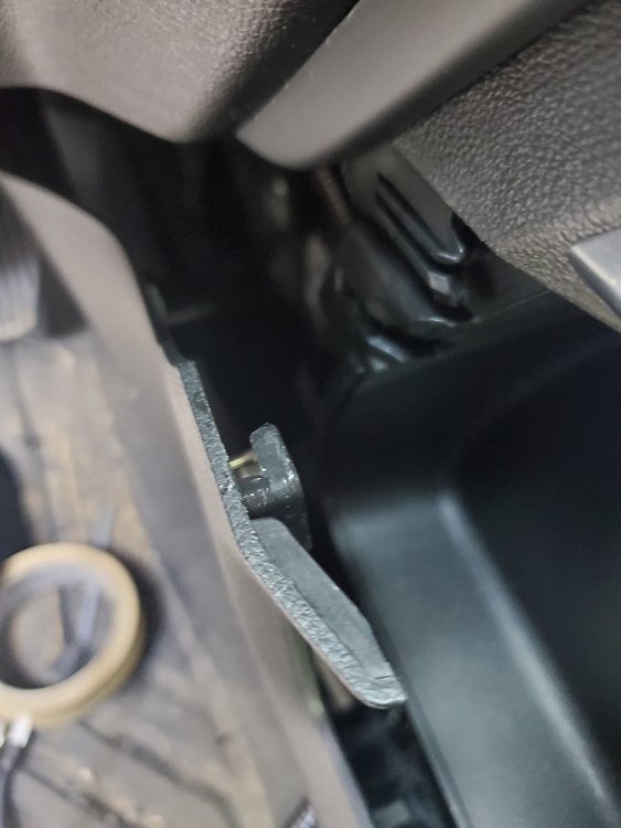

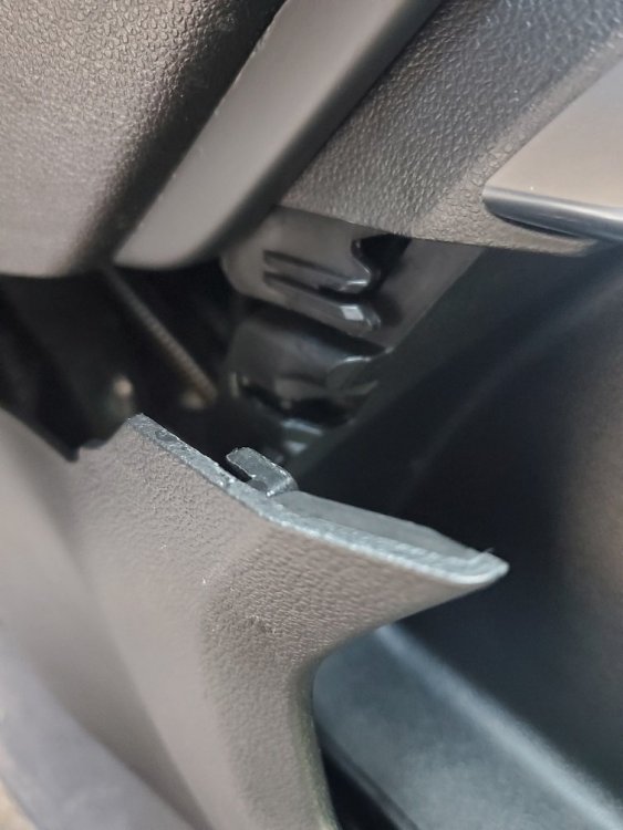

I will point out that the side console trim has a slide in/out tab that wasn't identified on the write up and I broke them off. Had to glue them back and then all good. Anyway, see my 2 (1x on/off lit switch and 1 moment switch for my front light bar) and the 6 other switch locations on the side console.
FYI I found another port on the passenger side in case others need more room to run wire through the fire wall.
This was a time consuming re/re but I like the commercial grade stuff on a work truck over the other stuff.
Yeah those tabs on the center console were fun to figure out!   Nice pic post of those.   Yeah I used the firewall port on the other size to fish a larger gauge wire back under the rear seat where I installed my air compressor, still use the upfitter switches to turn it on and off.  Still need to find some decent aux light pics for the 2020 trucks yet.

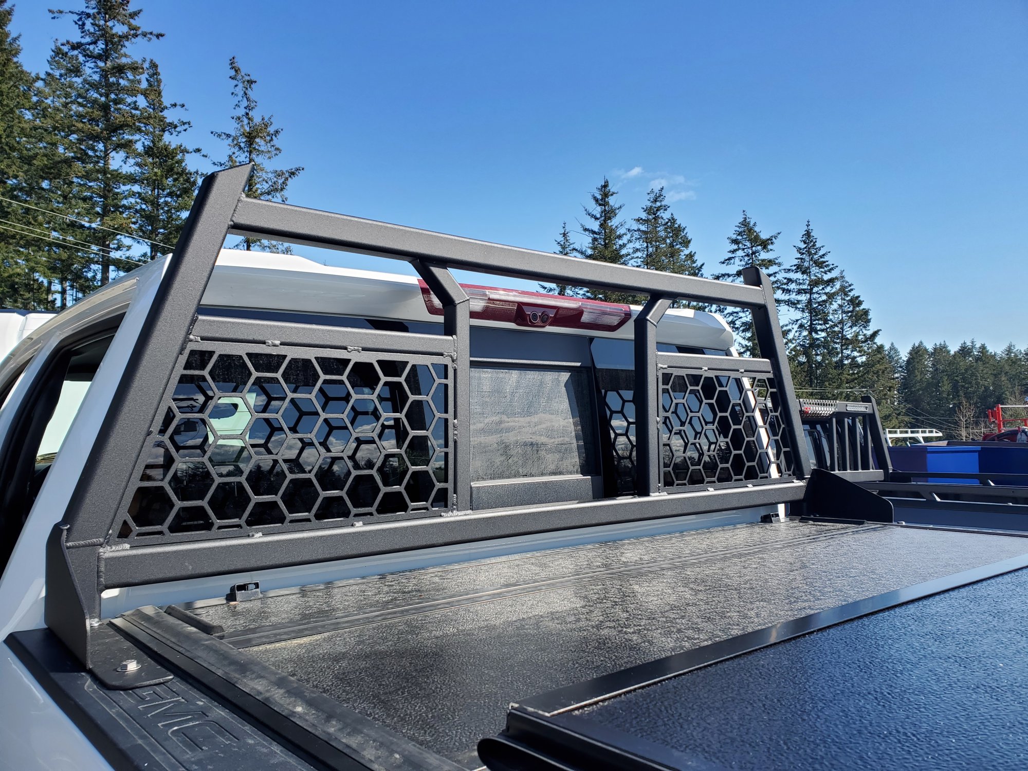

My progress to date... Custom built headache rack to not block the cameras and for service lights and a yellow rotating beacon (tomorrow). Have the big 32" Strands Light Bar installed but not wired yet too. Company logos were today as well.
