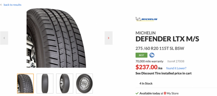

2 minutes ago, Nathan Banga said:
Would these be a good match. They seem to have really good reviews.
Those would be ultra smooth like a car. I highly recommend those to anyone but if you want some off road look a mild all terrain will still ride fine.
I want an all terrain tire but I also want to keep the stock ride, so I will be going with Ridge Grappler 275/60R20 Non-LT rating, or Terra Grappler 275/65r20 Non-LT rating. I think the good year duratrac comes in a 275/60r20 non-LT tire which would probably be the largest non LT mud tire you can fine.

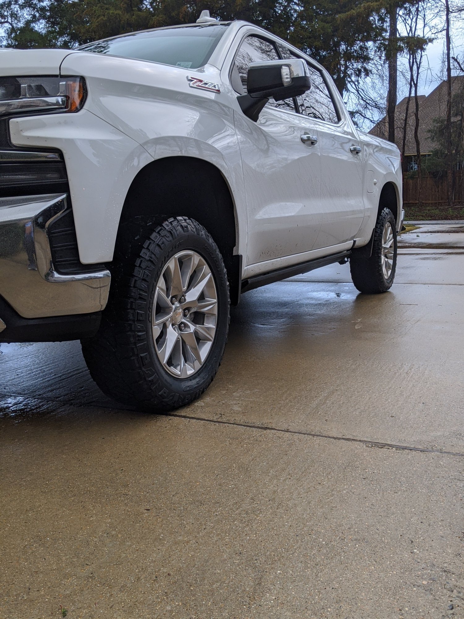

(Here is a picture that I saved from a forum member of the Ridge Grappler tires that I was referring to)
Michelin Defenders are excellent tires.  I have them on my F250 and they are super quiet and super smooth on the highway.  I will most likely be putting them on my 2020 Z71 when the Brigestone Duelers wear out, but the Duelers have been excellent and quiet tires so far as well.
Update. After a really really bad experience at discount tire getting the new tires installed it’s all done. Went with those Michelin’s. Definitely doesn’t look as good but drives like a million dollars now. If anyone’s in the market for those tires with 3,000 miles or the original ltz 20s with wheels tires and sensors I’ll take best offer, located not too far from Chicago. Thanks again for all your help everyone!
