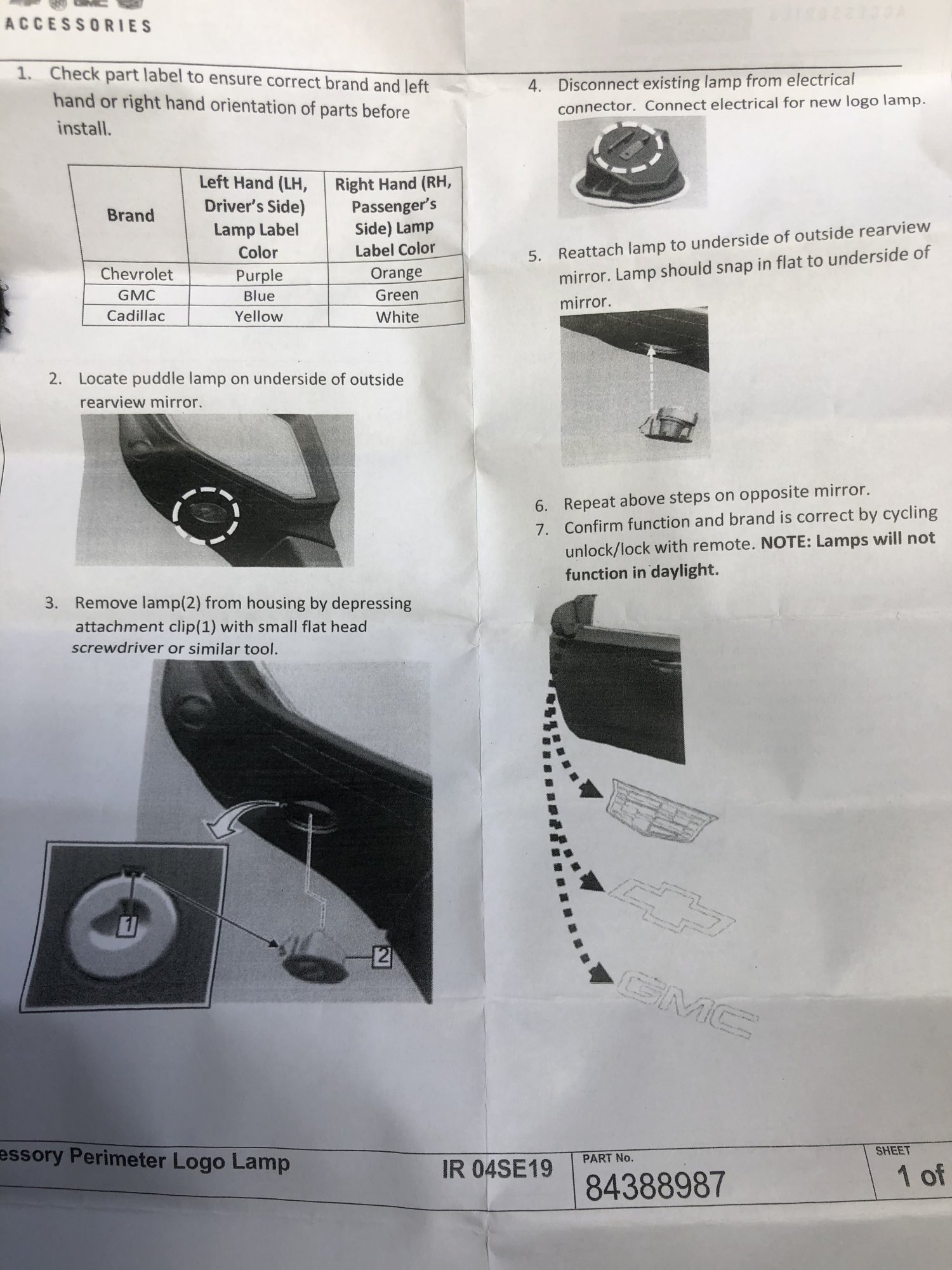

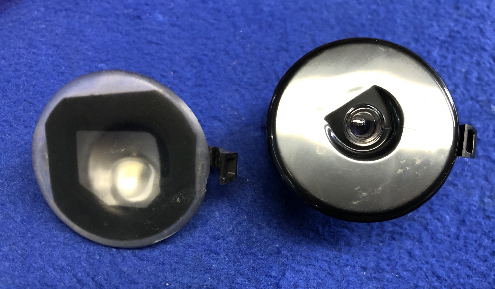

Pretty sweet, just put mine in. Noticed that the stock lights have K2XX stickers on them. That might mean that 2014-2018 guys could use these logo ones too (if the aim is similar). Not sure if they are being sold that way or not.
No nighttime pics yet, just instructions, invoice and side by side with stock on the left for anyone curious.

Looks good! Does it illuminate the ground and the area around the logo better than the stock lights? Did you get those through ShopChevyParts?

If you google the PN, 84408372...their store is the top hit with a 10% code. Best price I could find when I ordered ‘em last week.
All of the light is concentrated to the bowtie, so none of the ground around it really gets lit. I never really relied on the light from the originals but if you do, this mod ain’t for you.
The light output was so poor on my OEM puddle lamps that I didn’t even notice them, when I saw these lights were available I had to go and check to see if I even had puddle lamps as I was unsure if I did. I’m much happier with these lights, GM did well with them.

I purchased mine from shopchevyparts.com get the discount. They are for Chevy LTZ and High Country options or the top tier GMC truck brand. They are plug and play, pop out the OEM and insert these they are really bright and seeing the bowtie shining on the ground after dark when unlocking truck is sharp. I installed mine only small screw driver required very simple. They install in outside rear view mirrors.
