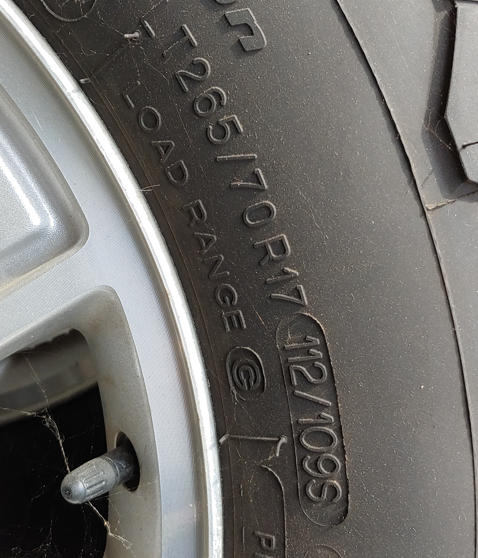

Some have posted that the limiter set by factory based on the tires it was born with.
I can't verify,
but...police tahoe probably has different speed rating tires than crew cab 1/2 ton..
