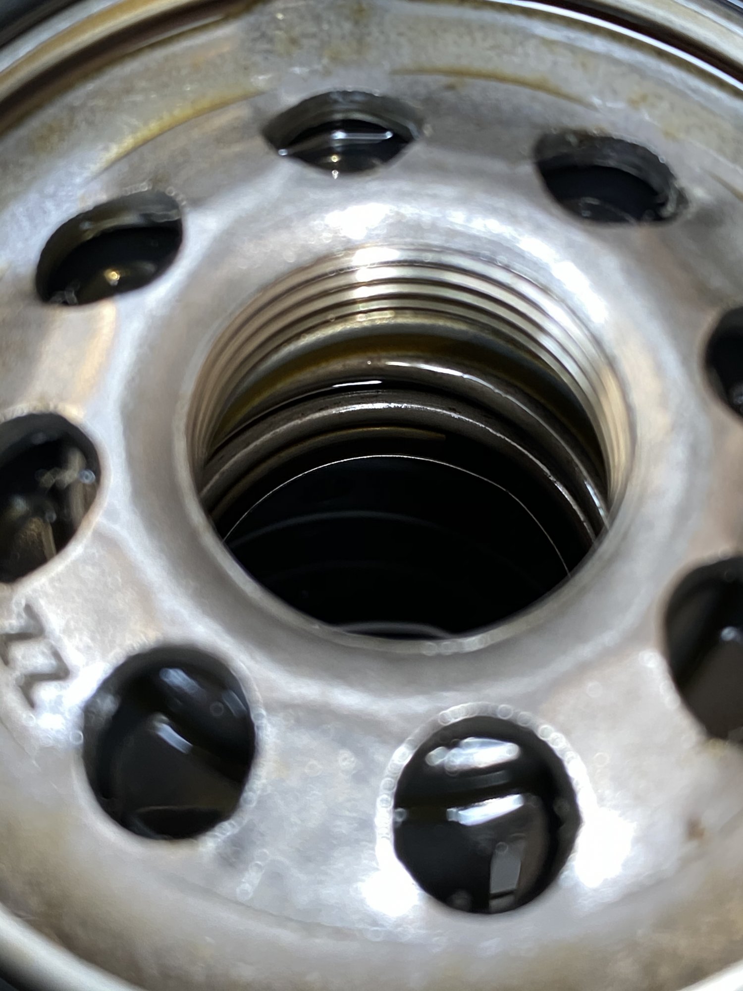

I heard about the leaking Napa Gold filters so I ended up just going with the dealership AC Delco PF63/PF63E since this is the first oil change and I’m not going to go long change intervals. I noticed there was no E in the new filter part number but it did have the new high flow plastic core. I looked inside the factory filter and it was very different, kinda weird looking. The factory filter had a sticker saying “replace with PF63E” (see photos). I guess the new PF63 and the PF63E are the same as long as they’re both the AC Delco Professional Series. Correct me if I’m wrong.

If you don't like the PF-63E, use the UPF-63R.  Higher quality filter.
Both have the same filter media, just the can is thicker and no plastic core along with a thicker metal top and different design. Been using PF63e. Never had an issue. 5k mile intervals.

Here’s the one the dealership gave me and neither of the part numbers match up to anything I’ve seen online... weird
