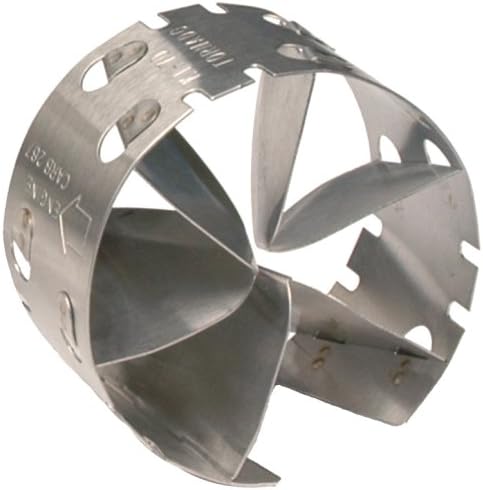

Hi, I just put a throttle body spacer on my 2019 LT TB (5.3L) with an S&B Cold Air Intake, and I figured I'd let you guys know what it did since it's a very easy and cheap mod. Haven't seen anyone else post about them.
After installing, it feels like the throttle response is a lot better, and that RPMs climb much faster. Throttle response feels like what sport mode was before the spacer, and on sport it feels even better. I haven't noticed any sound change because the S&B is already pretty loud as is. Link : https://www.americantrucks.com/proven-ground-silverado1500-throttle-body-spacer-s115556.html

The spacer didn't do anything, it's all in your head.
You're going to tell me that adding a 1/2 piece of metal with some swirls on it is going to improve throttle response and fuel mileage (what the company claims)?? My questions are how and where is the proof. The air going into the throttle body is already smooth and once it hits the throttle blade there is not enough space between the blade and the swirls to make it smooth again. Also the minimal air volume gained by that spacer doesn't help anything.
Spacers work on carbs far better because of their design and or when you want to increase the length of the intake plenum for certain applications. These TB spacers are just a gimmick and a great way to make money off people. $15 part which takes 20 minutes to design in solidworks that sells for $90 is great profit.
  • Thanks 1
Spacers had some use under carburetors at one time to increase 'plenum volume' and didn't always work then. Modern GDI manifolds would be unaffected by a few cubic inches of volume increase to an already really large natural volume old dual plane manifolds lacked.  Really good marketing though.
Agree with the above. I could pull it off without you knowing I did so, you would never notice the difference. That extra pep you have is due to your wallet being lighter and your foot being heavier. But it's your $$.
