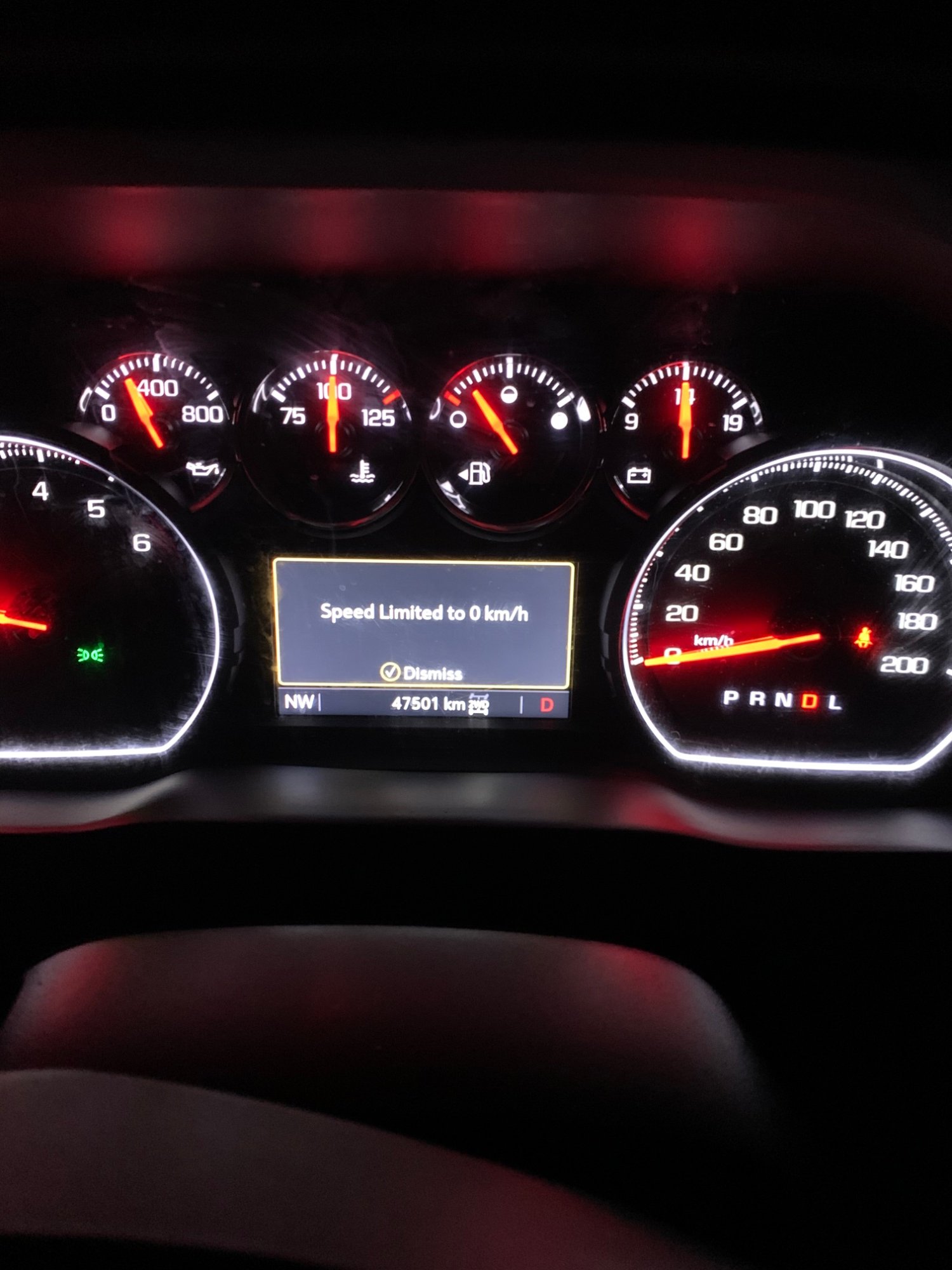

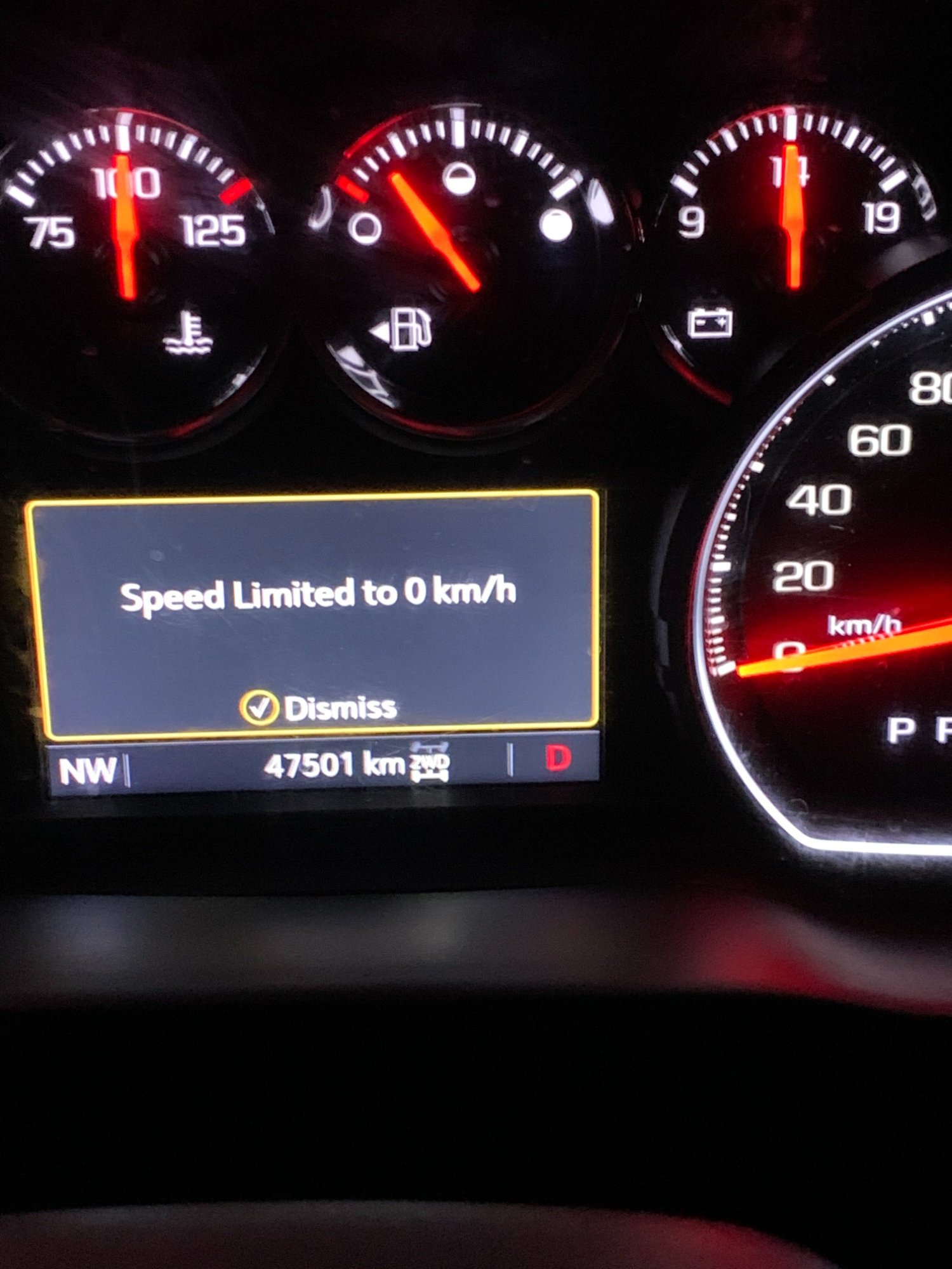

WhydIGoBack Posted September 23, 2021 Share Posted September 23, 2021 Just got 19 RST tried the options now have speed disabled to 0km and engine reduced power owned the truck 5 hrs Quote Link to comment Share on other sites More sharing options...
WhydIGoBack Posted September 23, 2021 Author Share Posted September 23, 2021 Cannot figure anything out other than a pile of anything O2 sensors TPS throttle positioning sensor etc runs idles revs until gear engaged then no throttle and trans is dead ! Truck is a lawn ornament Quote Link to comment Share on other sites More sharing options...

Transient Posted September 26, 2021 Share Posted September 26, 2021 Iirc, there's a way to limit the speed via the settings of the DIC. If you exceed that speed you'll get a message like what you're seeing. You may have inadvertently set the notification to 0 kph while exploring the settings. Quote Link to comment Share on other sites More sharing options...

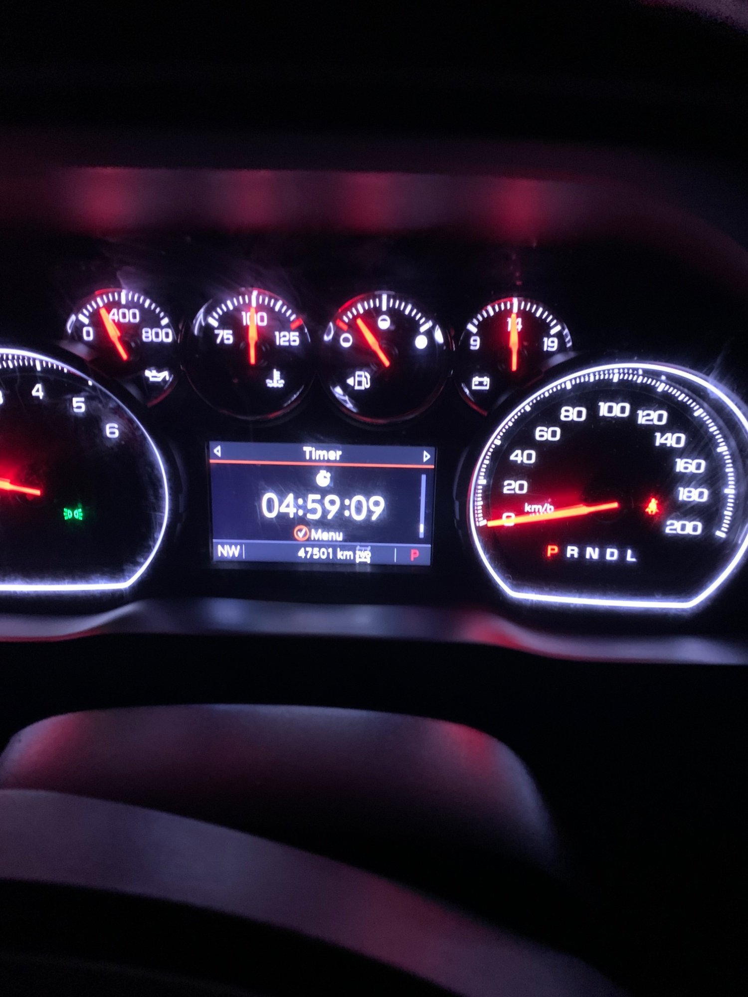

BIGDOGx Posted September 27, 2021 Share Posted September 27, 2021 On 9/24/2021 at 9:19 PM, THE YETI said: 5 hours and 47000kms. Crazy. That truck is fast. I would suggest taking that ****** right back to the dealer you got it from . If you got a smoking deal and paid cash for an under the table no warranty vehicle then scan for codes. Haven't heard of crazy flooding like down south up here so maybe a VIN search can help with any claims that you may not find out from a dealer VIN search. To me if it was a purchase from a business though sounds like I would have it fixed ASAP or my cash back, PERIOD. I think it was a timer setting and not the engine hours. Quote Link to comment Share on other sites More sharing options...
JJ461 Posted September 27, 2021 Share Posted September 27, 2021 Does it do the same thing with both keys, maybe you somehow set the teen driver mode or the valet mode. Quote Link to comment Share on other sites More sharing options...
THE YETI Posted September 28, 2021 Share Posted September 28, 2021 (edited) 11 hours ago, BIGDOGx said: I think it was a timer setting and not the engine hours. That would make more sense. Lol Figure anything else out in the meantime? I'm guessing maybe its been drivable since I last stopped in here? Edited September 28, 2021 by THE YETI Quote Link to comment Share on other sites More sharing options...
