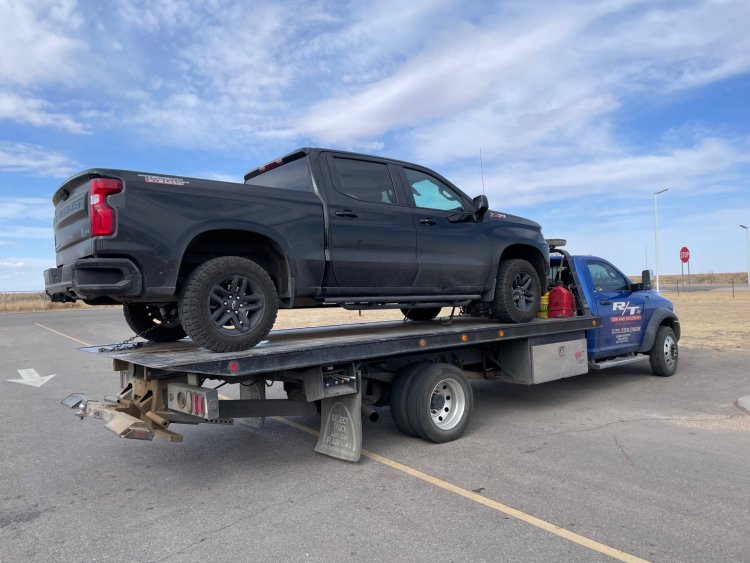

My 2021 trail boss is in the shop right now for lifter failure at 15k miles. I’ve seen several posts about the same failure and I’m curious if anyone can share how their truck is running now? How many miles have you put on your truck since the repair and have you had any additional issues?A499FDEA-376F-4CEC-9A3A-EC89BB8CF766.thumb.jpeg.f816191c7f28c72b3c5d3f1e03cc81ad.jpeg

Our '21 Silverado with L84 5.3 got the first flashing check engine light at 585 miles. The dealer replaced the lifters only on cylinders #6 and #8 after several visits (the light came back four times in total) around 1800 miles.
The truck is now at about 12,500 miles and the issue hasn't come back yet, but 1) I change the oil every 3,000 miles as a preventative measure, and 2) I exclusively drive the truck in L7 on the 8-speed to disable DFM. Despite these measures, I wouldn't be surprised if it happened again given only four out of 16 lifters were replaced.
I've mentioned this in other DFM lifter threads, too, but if they remove your serpentine belt for any reason as part of the repair, have them replace it. Ours started failing at 6300 miles because they took it off twice and stretch fit belts are one-time use. They replaced the serpentine belt, AC belt, and idler pulley on ours under warranty. Also make sure they clip your heater hoses back into place. They didn't on ours and I had to clip one back in its retainer so it wouldn't rub on the frame and squeak going over bumps.
Even without the manufacturing defect that affected our batch of engines, the lifters will most likely fail between 60,000 and 80,000 miles under normal use, anyway, due to the poor design. If you are not leasing the truck, I would plan on trading it before the 5 year/60,000 mile powertrain warranty is up or get an extended warranty if you hope to keep it longer. We negotiated an extended component coverage (6 years/100,000 miles) letter for the engine on ours that's tied to the VIN number due to the terrible, dragged out repair experience we had with ours over the course of a few months. It's at minimum a $5,000 job out of warranty to get the lifters replaced at the dealer, and if it takes out the whole engine due to metal debris recirculating, it can be as much as $11,000-12,000 for a new engine.
With all of that said, we plan on trading in the truck later this year. We use it to tow a modestly sized 4,000 lbs. GVWR camper and I can't deal with a practically brand new truck randomly failing in the middle of nowhere hours from home. No amount of warranty coverage will make you any less screwed in that scenario.

Thanks for the information, all good advice! We went thru issues with a 2015 Ram 1500 with the eco diesel. The whole engine went out at 30k and then none stop issues after that. I was hoping to do better going back to Chevy! Ed are going to watch it and see how it does, if it gives us more trouble we will trade it in.

We decided we no longer have confidence in the truck! We ended up with 4 lifters replaced and I had no interest in waiting to see if 12 more would go out and leave us stranded again. Zero interest from GM to make it right and I have been working with GM customer service to try and get reimbursed for hotel and gas. Apparently once you have an agent assigned you can’t get a new one and mine has taken 3 weeks to get no where (I have requested a supervisor call me but that has not happened yet). We are done with chevy and back with ford! I have more confidence in the 3.5 V6!
