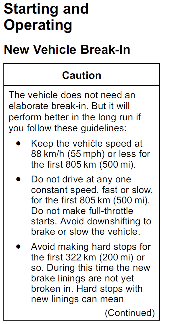

Based on the knowledge of engine builders that I have worked with on various autos, try not to keep the RPM's too steady, prolonged driving at a stationary RPM's is not preferred when trying to get the piston rings to seat and establish a good seal.  Despite what many people say, a good quick romp or two on the go fast pedal is not a bad thing and generates the heat and pressures required to make the piston rings form a good seal.  Just don't hang the engine at high RPMs to the point where its bouncing off the rev limiter.  Vary your RPM's as best you can and let the engine get up to full operating temperature before you shut it down.
I know it sounds funny but manually putting your truck into a specific gear once warm, and then accelerating to a higher rpm and letting the engine slow you down, is a good way to break in the rings as well.  It varies RPMS, generates adequate heat and pressure, and is easy on the engine.  The key is to very your rpms and loads, don't let it sit at a stationary RPM for prolonged use if at all possible.
Found this in the Owners Manual for Break In, basically says what I mentioned above:
Probably the same people who wrote owners manuals on proper vehicle break ins. Told us not to eat salt, egg yokes, meat, bacon and drink diet soda. I don’t follow their advice anymore either.

I'm with you for the most part, on most things.  Its probably the difference between being within 99.0% of the acceptable efficiency rating and 99.1% when it comes to an OEM engine.  However, a break in procedure has never made the engine less efficient or less properly broken in :)
