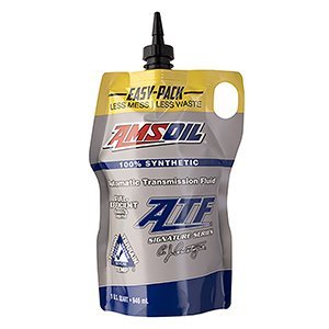

I changed out the front and rear differential fluids on my Silverado at 500 miles as well as my transfer case.  The transmission I did at 25k only because I wasn't able to do it myself and had the dealer do it for me.  Cost me $130 for them to change out the transmission fluid.  I provided the AMSOIL ATL transmission fluid.
The differentials I used AMSOIL's Severe Gear 75w-90 in the Easy Packs.  It was super easy and no mess like with a pump from a bottle.
You can find the AMSOIL products if you want for your truck here.
If you are interested in AMSOIL let me know and I can send you a quote delivered to your door.
SVGPK.jpg.d0241853f8cbe9fbac103b3d04aca34e.jpgatlpk.jpg.2916d38661acfa995e92497ed38ff6dd.jpg
