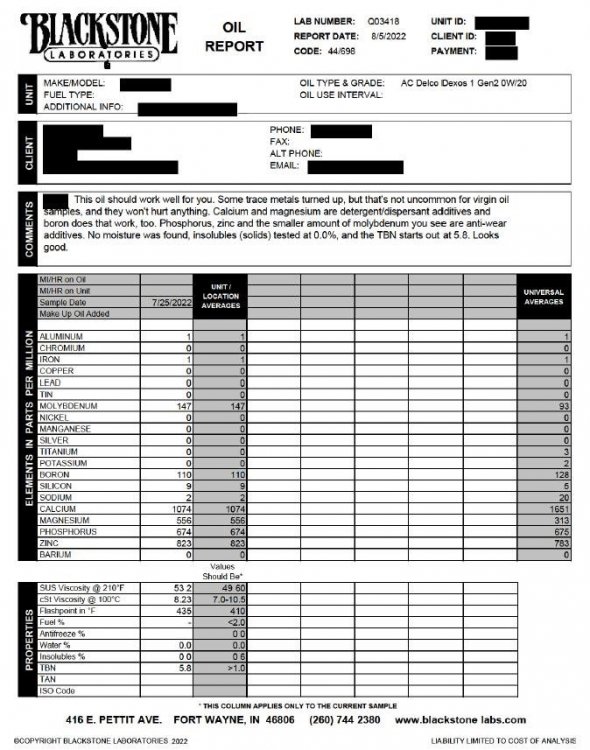

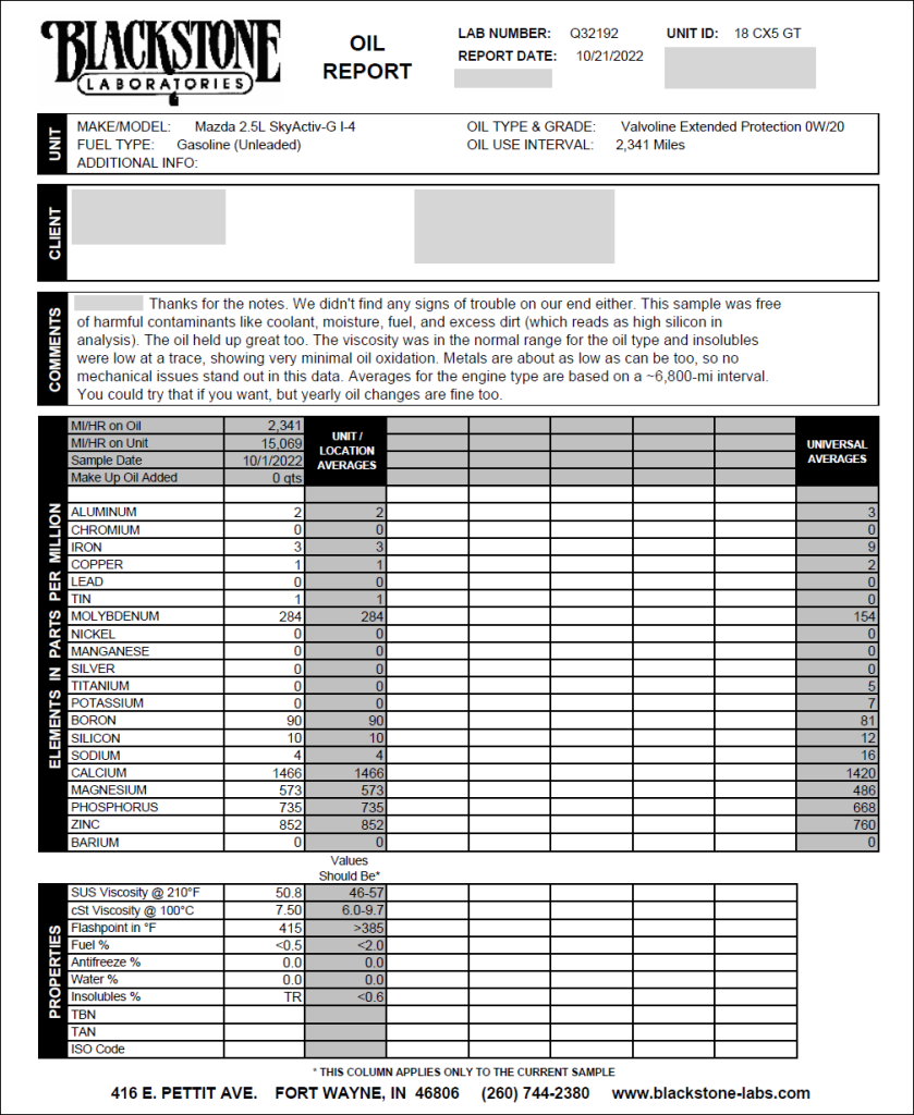

I have this habit every time I buy new car or truck I like to dump the factory filled oil with in the first 500 miles or lass, for a simple reason that the brand new engine might have some excess part braking materials in it, I don't want that to circulate in the motor for 5-7k miles.  so this weekend i'll be changing my oil on my new at4 I like to use the acdelco but the price on that is just crazy, I did research and the gm oil actually is not bad at all its actually way better than some popular brands out there, I'll post a additive package if you know to read it you will see how good the gm oil is, but I will not be using that, I decide to go with a Valvoline Extended Protection , any ways here is the ac delco oil package and the 2nd one is from the valvoline oil. oh and by the way do you dump your 1st oil sooner than you should, or you going full recommended milage b4 you change?

 many people are doing this, I'm sure its ok if you don't , but I like to do it, plus I want to upgrade my oil filter with wix XP also I love the Valvoline Extended Protection if you look at the additive package up in the original post looks great, I also have this oil in my wife new Cherokee L and is performing great, right now I am at 260 miles, by next weekend ill be little over 500, and the new oil is going in.next is change will follow at total miles of 2500, next will be at 5000,and after that every 5k, and hopefully I will have a strong healthy   running v8 for a long time. cheers from MICHIGAN !!
