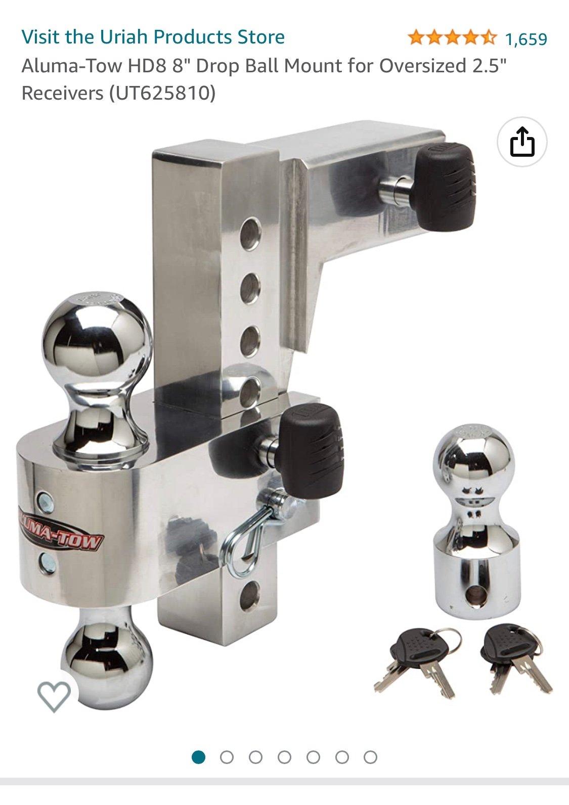

anyone use this aluma tow brand? It’s aluminum and has a 2.5” mount with a wide range of heights and 3 balls. It’s 229 on Amazon.

So I want to buy a mount and I think I’m leaning towards a one size fits all type deal. I’ve heard b&w and weigh safe are good along with genY. All of those seem to cost 350-400.

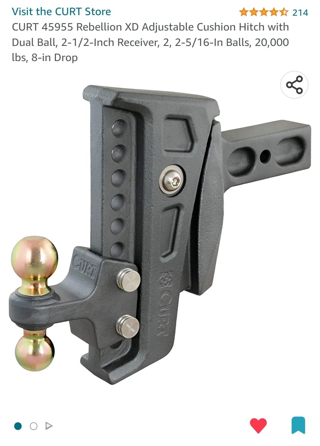

This is the one I was just looking at last night.

I’ll have to check this curt out too. Curt is a WI company too.
just looked. Holy guacamole. 650.00 dollars. If I towed massive weight daily I could justify it but woofta. Curt makes top of the line stuff though.
It has everything someone could want even comes with the locks and a case. The max tow with the 2 5/16 ball is 12k though. Probably fine for me but maybe not everyone.
It's pricey for sure! That's the only reason I haven't bought it since I don't actually need it yet. But soon enough I will need it.
